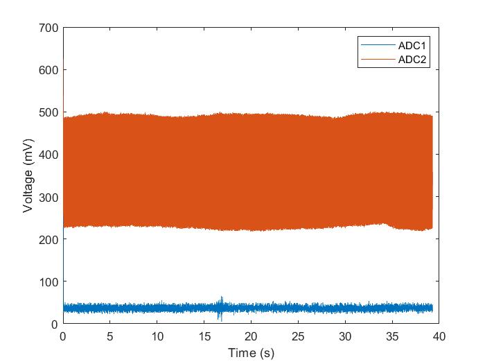

Hello All,
I am working on a project that requires reading in analog data of 2 ADC channels. The circuits before each of the channels are identical. However, when I give, for example, a 50 Hz sinusoid as an input to both circuits, ADC 2 reads the signal just fine while ADC 1 (all of its channels) read in noise near 0 volts. I tested to see if it was a circuit error by swapping which ADC channel reads each circuit, and ADC 1 still only reads noise near 0 volts telling me that there is either an issue with my code or an issue with the microcontroller (I have tested this on 3 different ESP32 S3s and got the same outcome). Could anyone tell me why this would be happening? Is it a programming issue? Is it a firmware bug? I have left a graph of the voltage reading below as well as the code flashed to the microcontroller.

    // Configure desired precision and attenuation for ADC pins
    adc1_config_width(ADC_WIDTH_BIT_DEFAULT);
    adc1_config_channel_atten(ADC1_CHANNEL_3,ADC_ATTEN_DB_0);
    adc2_config_channel_atten(ADC2_CHANNEL_0,ADC_ATTEN_DB_0);
    // Create ADC channel characteristics structs for use in calibration functions
    esp_adc_cal_characteristics_t adc1_chars;
    esp_adc_cal_characteristics_t adc2_chars;
    esp_adc_cal_characterize(ADC_UNIT_1,ADC_ATTEN_DB_0,ADC_WIDTH_BIT_DEFAULT,1100,&adc1_chars);
    esp_adc_cal_characterize(ADC_UNIT_2,ADC_ATTEN_DB_0,ADC_WIDTH_BIT_DEFAULT,1100,&adc2_chars);
    int val1;
    int val2;
    int n = 44100;
    int counter = 0;
    float difference;
    while(true){
        val1 = adc1_get_raw(ADC1_CHANNEL_3);
        adc2_get_raw(ADC2_CHANNEL_0,ADC_WIDTH_BIT_DEFAULT,&val2);
        int adc1_voltage = esp_adc_cal_raw_to_voltage(val1,&adc1_chars);
        int adc2_voltage = esp_adc_cal_raw_to_voltage(val2,&adc2_chars);
        printf("\n%d, %d",adc1_voltage,adc2_voltage);
        vTaskDelay(1);
