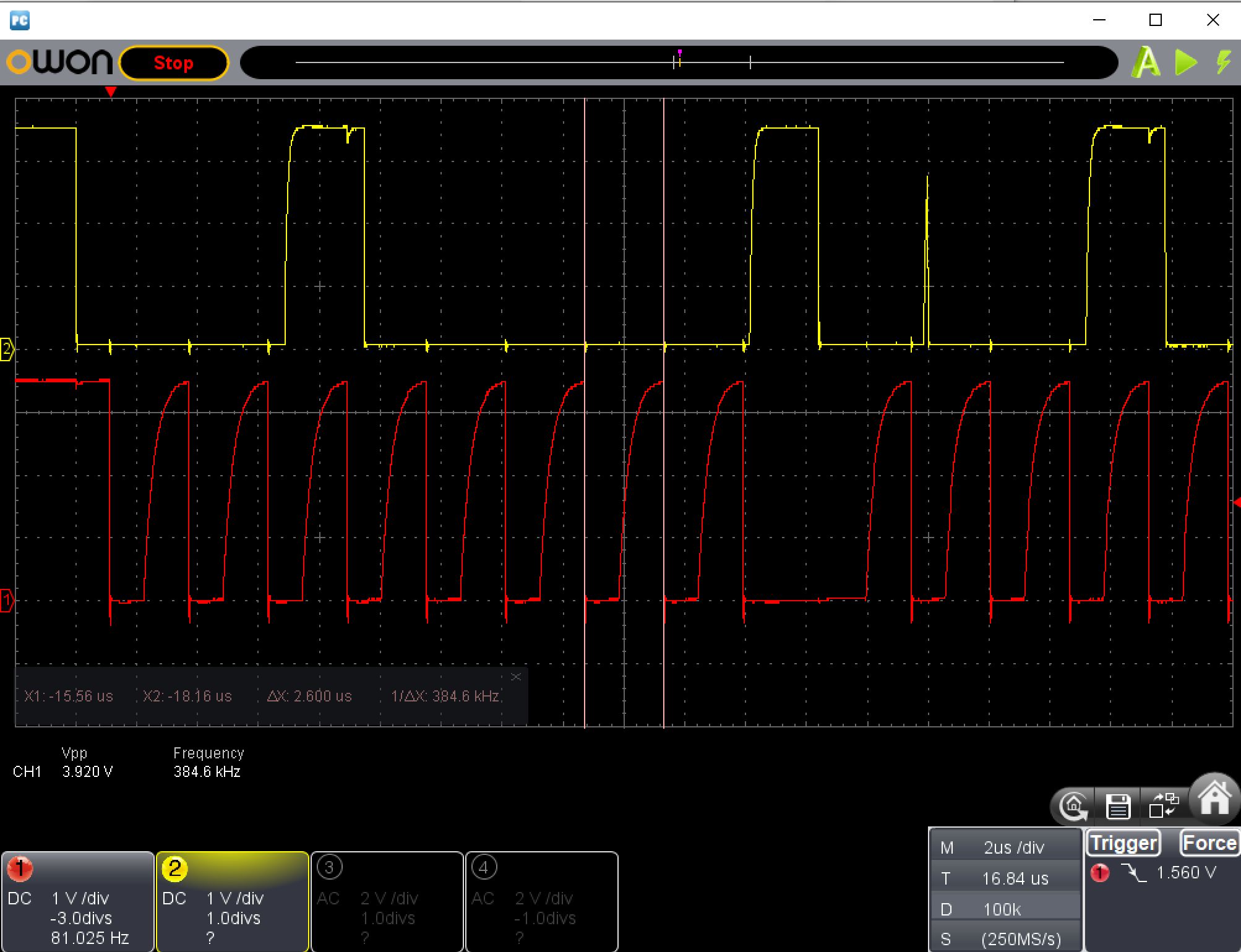

I'm experiencing the same issue with an ESP32-WROOM-32 using the latest Arduino ESP32 core.
SDK:v4.4-dev-3569-g6a7d83af19-dirty
IDF:v4.4-dev-3569-g6a7d83af19-dirty
The ESP32 is the I2C master (IO21, IO22), communicating with an STM32G0 co-processor slave.
At standard speeds (100kbps), it works reasonably well, but at fast mode (400kbps), communications
become unreliable. I'm using 2K pull-ups on SCL and SDA and the waveform looks reasonable.
However there are at least two issues:
1) SCL is clocked significantly slower than the configured setting; for example, configuring for 450kbps results in SCL being clocked around 384kHz. (the focus of this thread)
2) Perhaps more importantly, the ESP32 appears not to be asserting SDA quickly enough following the clock after an ACK from the slave. This glitching of SDA happens after each ACK at 400kHz.
