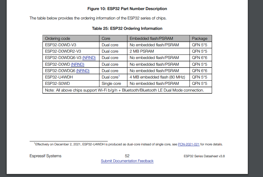

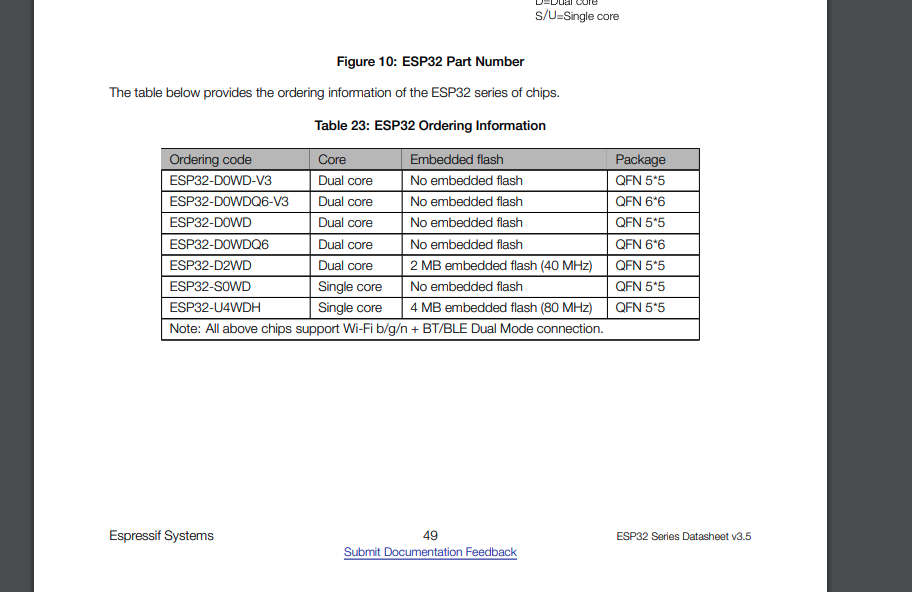

Could someone please confirm how many cores the U4WDH has? I there is conflicting information at various sites on the internet. See screenshots from two different datasheets....
Screen Shot 2022-04-25 at 8.53.24 PM.png (106.71 KiB) Viewed 2353 times
Screen Shot 2022-04-25 at 8.53.44 PM.png (123.52 KiB) Viewed 2353 times

The answer is right there in the footnote in the second image
