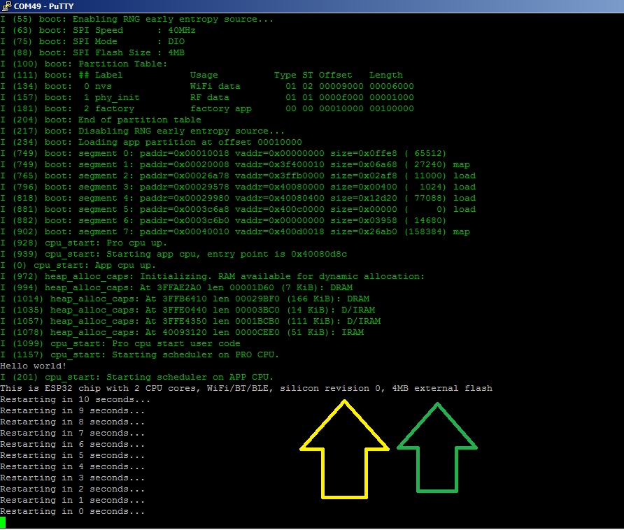

wrover modul still revision 0
can we check on Rev0 wrover the pSRAM?
edit:
tested -
--- ok - no pointer --

ok - Rev0 does not support pSRAM
With these Wrover'n I had actually already assumed.
PSRAM would be supported.
Because they were also installed on it.
Could not you test this before?
i.e. You can remove them now because they are not usable.
Very unfortunate - and honest - I am a little sad about it.
But ok - now certainty is there and now we know it - away with the theme.
the summer comes.
thank you for your effort Jeroen!

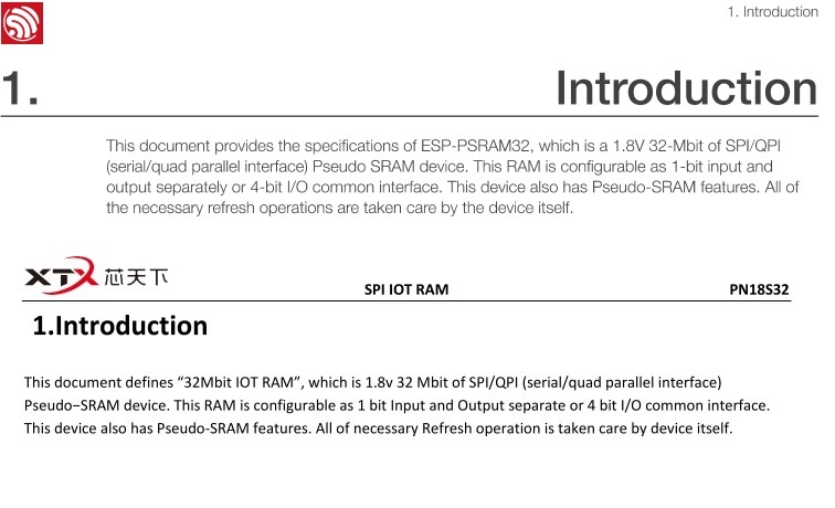

one thing i do not understand, perhabs you can help in this way with an Info about,
i know - you are very detailed and you are visionaer - so i ask you for hope to get answers:

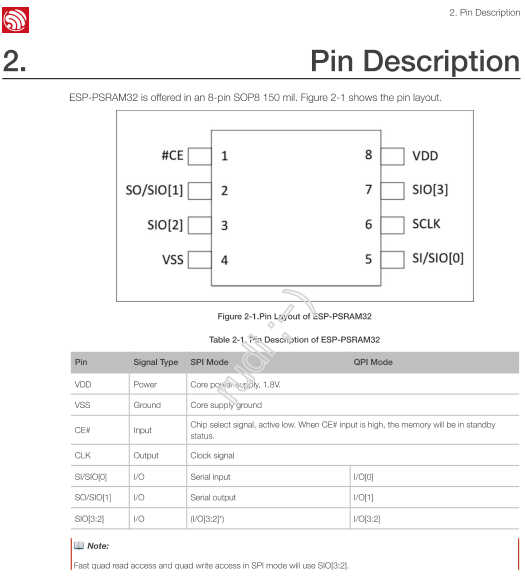

in the technical reference there is a picture, that psram share CLK with flash
you know.
we know now, that this picture must be wrong, cause CLK need to separate for psram. and here comes the same confirm
- at first, can you confirm, the picture is wrong?
- does this mean, that only the workaround need this for rev1 or is this gerenally for the psram then?
we know now, that the pins on this picture must be wrong then too ?! ,
cause the pic shows DI, DO, WP and HOLD QIO mode
but in the pSRAM support, we use DI, DO and WP ( mode ? )
this is a diffenet mode -
hold is not named and not use.
i ask for the mode, cause we have 1 bit Input and Output separate or 4 bit I/O common interface
1 bit Input and Output separate means DI, DO right?
and
4 bit I/O common interface means SD_0..SD_3, right?
btw XTX sales espressif brandmarked pSRAM - so i think - it is the same

To connect the ESP-PSRAM chip to the ESP32, connect the following signals:
  • PSRAM /CE (pin 1) - ESP32 GPIO 17
    PSRAM SO (pin 2) - flash DO
    PSRAM SIO[2] (pin 3) - flash WP
    PSRAM SI (pin 5) - flash DI
    PSRAM SCLK (pin 6) - ESP32 GPIO 16
    PSRAM Vcc (pin 8) - ESP32 VCC_SDIO

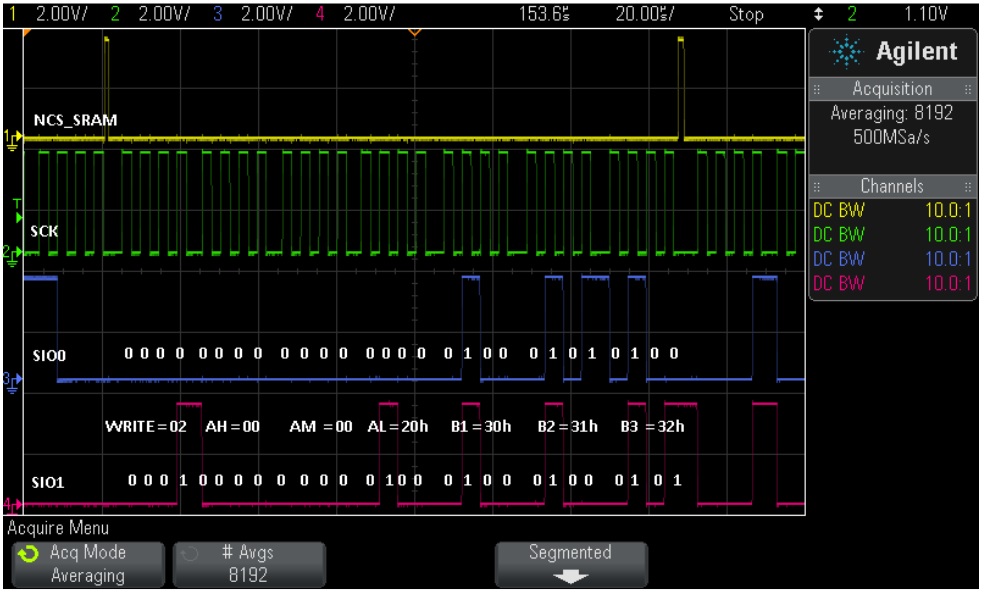

now its clearing, psram 1.8, flash 1.8, CLK and CS in the VSDIO domain, and CLK must be separate.
now we need a code sceleton for using this pSRAM as usually SPI RAM Jeroen,
is this possible to test this on this way in a short time ( 1-2 days )
and do the same thing for a test ->
can you help? can you provide a code example to huck up the pSRAM on wrover rev0 SoC'S ?
if i can use the pSRAM on this way for pushing data and read data
this helps - we need not the cache maloc version in this step
( later sure - we need this - but then better wait and use "ESP64" instead ESP32 rev1 with workarounds )

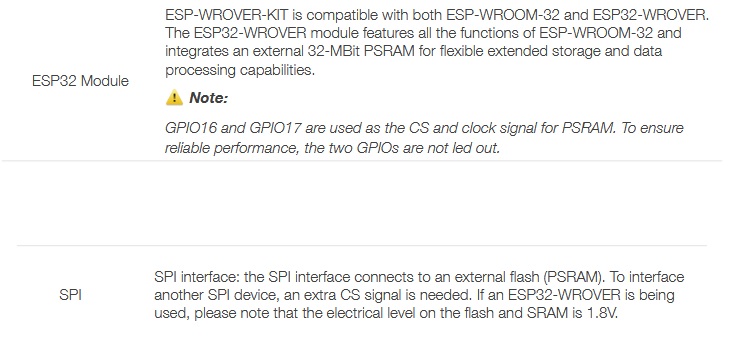

can it be that now the pins are swapped ? or is this a mistake?
like i sayed, the wrover starting guide says,
"GPIO16 and GPIO17 are used as the CS and clock signal for PSRAM. To ensure
reliable performance, the two GPIOs are not led out."
means
GPIO16 = CS
GPIO17= CLK
but in the future/psram_maloc
there are the pins swapped
btw:
the psram code itself speaks the same like the Getting Started Guide
#define PSRAM_CLK_IO      17
#define PSRAM_CS_IO 16
guys please!
think now its time @espressif to figure this on right way out that we can all right work on it?
very confusing more and more this theme.
i think i go now "play" bit bang with pSRAM on this way again

Please refer to the actual documentation of the specific pinouts, like the relevant documentation of external RAM in esp-idf or the psram code itself, for the pinouts. Sentences like 'GPIO17 and GPIO16 are used as CS and CLK' are only meant to illustrate that these two pins are in use, they are not meant to derive a pinout from (we'd use 'respectively' in that case to indicate there's an 1-to-1 match.)
The WP pin is in use because the PSRAM also allows quad-IO mode, with data going through DI, DO, WP and HOLD at the same time.
The datasheet illustrates the general case for adding an extra RAM chip to the flash bus. In this case, however, because of an incompatibility of the requirements between most flash chips and the specific type of RAM-chip that is the ESP-PSRAM32, we also need a separate clock line.

ok - i will not take the document "wrover kit getting started" for my understand on "illustrate"
i will now speak facts:
https://github.com/espressif/esp-idf/tr ... ram_malloc
the Readme of the future/psram_maloc
speak,
that CE goes to GPIO 17
that SCLK goes to GPIO 16
and in the code of this repo
https://github.com/espressif/esp-idf/bl ... 32/psram.c
on line 50
https://github.com/espressif/esp-idf/bl ... sram.c#L50
on line 51
https://github.com/espressif/esp-idf/bl ... sram.c#L51
info about the pin function is swapped - what is right or not right - we do not know, one part must here change.
sory for the hint from me that there must be a wrong part or swapped pins.

psram
if we use 1-bit mode, means we must know, where pins SI, SO - but no WP pin or HOLD
if we use 4-bit mode, means we must know, where pins S[0] S[1] S[2] S[3] - but no WP pin
WP pin is no data pin
if pin is named as WP pin
then is spoke from Write Protect Pin - no data pin
WP means, "Enables/Disables the Lock-Down function of the status register"
the HOLD pin is the same, there is no data pin with HOLD
HOLD means, "Suspends a serial sequence to the memory without deselecting the device"
if you look in the pSRAM Datasheet, there is no WP or HOLD funtion for this pSRAM Device.
and there is no describtion for WP or/and HOLD funtion to the pSRAM Device.
if you talk from quad-IO mode, "DI, DO, WP and HOLD"
then this is absolutly wrong named jeroen - sry -
quad-IO mode means, S[0]...S[3] as data pins - as input and as output for data
in international technicals there is named sometime SD[0]..SD[3] or SIO[0]..SIO[3] too
but never WP or/and HOLD
this "function names" are not available in quad-IO mode.
please use norm pin names for the 1-4 bit mode on device and document
then there is no missunderstand in pins and pinfuntion.
if i read
SI
SO
WP#
HOLD#
means never quad mode - it is allways in simply SPI Mode
SI = Serial input ( MOSI )
SO = Serial output ( MISO)
MISO means - Master Input / Slave Output
MOSI means - Master Output / Slave Input
if i read ( left side, the right side is for your understand )
SIO[0] .. SI
SIO[1] .. SO
SIO[2] .. WP#
SIO[3] .. HOLD#
means quad mode - and there is no WP# Write Protect or HOLD# HOLD funtion
so never named the pins WP or/and HOLD in a quad-IO-mode cause there is no pin so named and functional used.
there are only data pins for IO
IO means
Input
Output
keep smile! i like you.
btw:
The "HOLD" Pin if you mean SIO[3] is not given in the last Readme, and is not given in the Code as GPIO HOLD#
this pin is missed in the Readme - where we must connect - and usually in the code used from/for SIO[3]
PSRAM SIO[3] (pin 7 ) - flash HOLD
is missing in the connect info
and if you read in the pSRAM Datasheet
Fast quad read access and quad write access in SPI mode will use SIO[3:2].
means like i wrote before.
if you not have, here my personal version:
NO WP or NO HOLD
again
keep smile - i like you
rudi

Huh, you're right - seems I skipped over pin 7. Thanks for noticing, will fix it as soon as I have time. Same with the code/documentation discrepancy - those should match up, will see which one is wrong.
I can't easily check the code now, but my guess is that WP and HOLD aren't mentioned anywhere in the PSRAM code because they're already set up correctly for the SPI flash. On a flash chip, in the right mode (quad I/O) they *are* actually used as data pins; it's just that quad I/O is a relatively new development, and seemingly the chip manufacturers still only use the old pin names. (See e.g. here, last sentence of 7.3 on page 8.)
