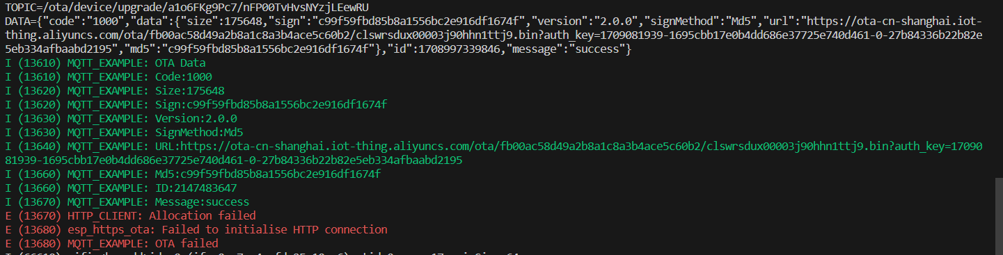

屏幕截图 2024-02-27 093503.png (60.77 KiB) Viewed 3728 times
