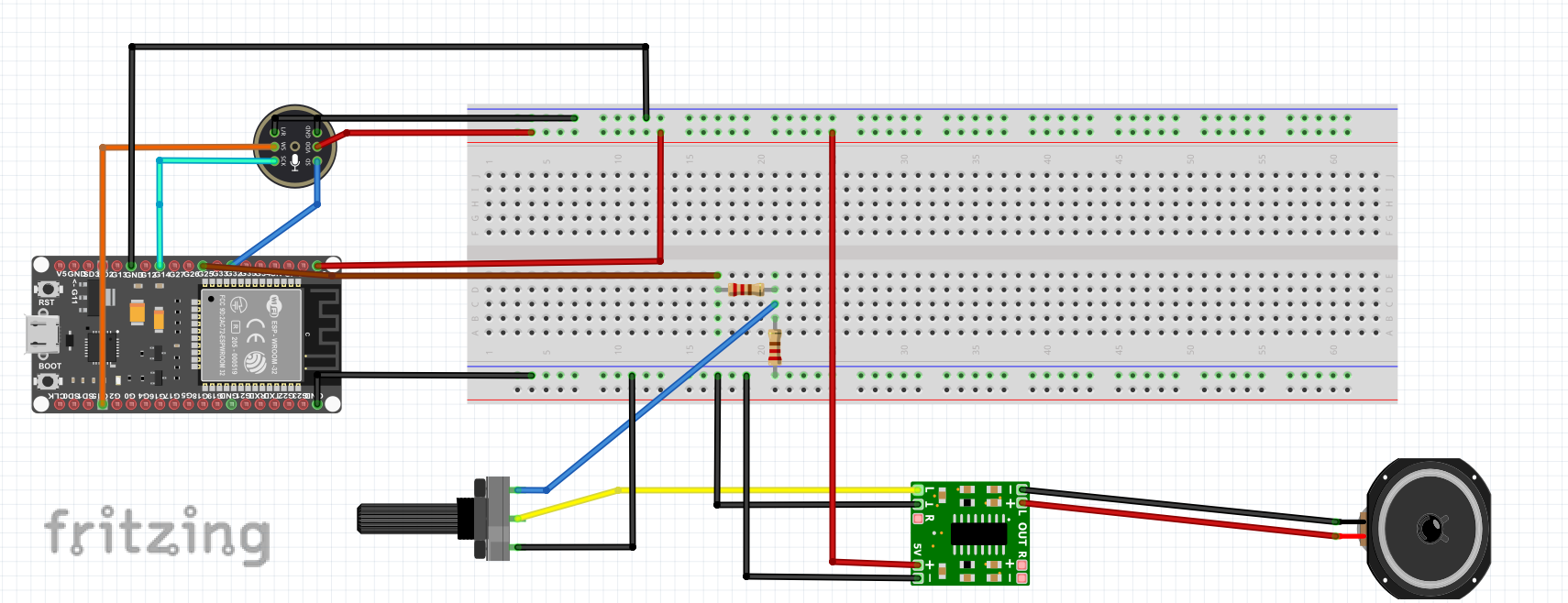

Hello !
My project is to make a voice amplifier with a mic INMP441 and a speaker on a esp32 card.
So I use the i2s protocol to collect the data from the mic and I convert the data to a 8-bits integer to send it to the DAC and then send it to the speaker (with a PAM8403 between).
The problem is that I can't transmit the sound from my microphone correctly to the speaker, there is only an unpleasant noise coming out of it.
If you have any suggestion, it would really help me.
I join my code there :

I think your problem has nothing to do with your code. It is related to the hardware. I think you'd better post your schematic. If you have created a PCB, you can post your layout to the following forum:
https://www.pcbway.com/project/shareproject/
There are many expert designers hanging around that forum who may guide you in the right direction regarding your design.

There is my shematic Image[/img]
