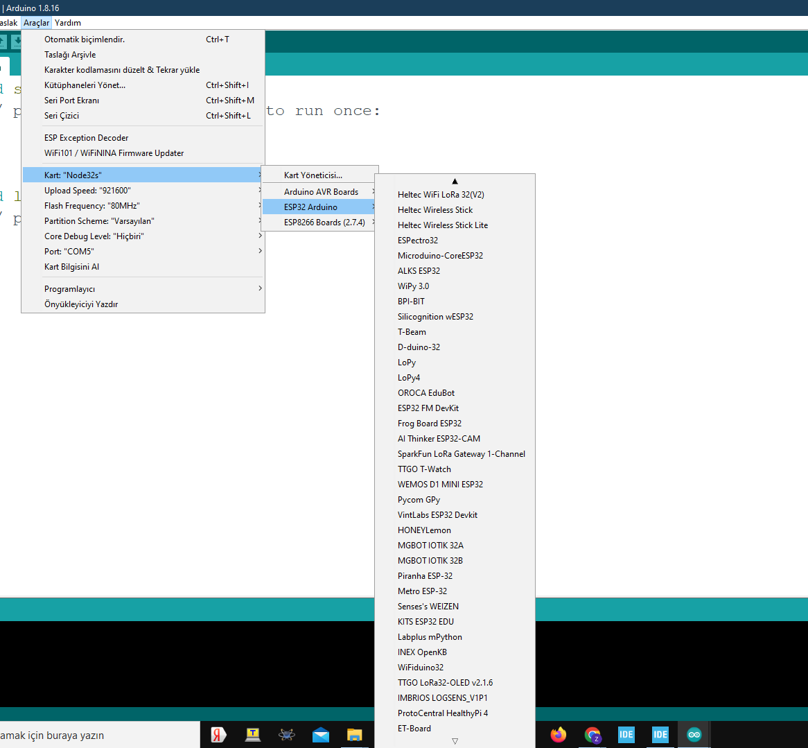

Hello. How to program ESp32C3N4 with Arduino. Which card should we choose?

You must have v2.0 or greater. Verify that you have the right URL for boards manager. https://docs.espressif.com/projects/ard ... lling.html
Select the ESP32C3 Dev Module.
