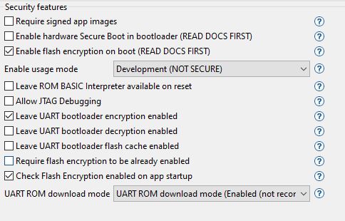

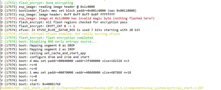

If I use the option Simulate eFuse operation in RAM and Development mode with activated UART ROM Download, I get some log message with the partition will be encrypted and co. If the process ready the bootloader hanging and not start the main program.
See on the picture. Hanging after boot: start: 0x40081768.
This debug message is coming directly after programming first restart the device, after secound restart, I get no output anymore.

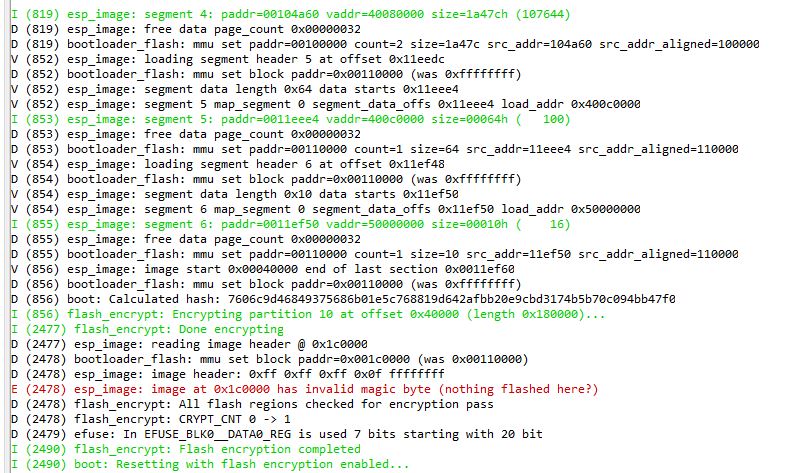

There is also some weird thing in the bootloader, i get an error that on ota_1 partition cannot be encrypted, because no magic number. This is true because with the IDE will be OTA_0 written.(OTA_1 stay empty) I tested also to write here the same FW with the download tool from ESP, but the main programm is still not start.

- Is there a setting in the sdk configuration that does not allow encryption? We modified some options, what we needed RAM and Flash speed, and some more options.
- Why does the bootloader not start the main program?
- Is there a program functionality difference between simulate efuse in ram, keep in flash or write it one in efuse?

Your code is encrypting the flash, but not setting the eFuses as such (as you enabled virtual eFuses), so the ROM tries to execute the code as plaintext but it can't as the actual flash is encrypted.

You answered one of my questions, according to them it is not possible to activate flash encryption if we don't program the efus! So both of the options are not usable Simulate or save in the flash.
I tested now without efuse simulation, and i have a different log but still not booting.

I am using development mode with UART, and I can reflash it, but it still nothing happen after restart. So I can say, this board are dead.

I get a new board, and I flash it with Development mode and Uart Rom download enable. I have the same problem, at Resetting with flash encryption enabled...stay everything hanging and no more function. I can reflash it but I have no output anymore and the cpu is not start.
This is the log output after first flashing:
Do you have any idea?
Thank you your help in advance.

I (814) flash_encrypt: Encrypting partition 10 at offset 0x40000 (length 0x180000)...
I (2435) flash_encrypt: Done encrypting
D (2435) esp_image: reading image header @ 0x1c0000
D (2435) bootloader_flash: mmu set block paddr=0x001c0000 (was 0x00110000)
D (2436) esp_image: image header: 0xff 0xff 0xff 0x0f ffffffff
E (2436) esp_image: image at 0x1c0000 has invalid magic byte (nothing flashed here?)
D (2436) flash_encrypt: All flash regions checked for encryption pass
D (2436) flash_encrypt: CRYPT_CNT 0 -> 1
D (2436) efuse: In EFUSE_BLK0__DATA0_REG is used 7 bits starting with 20 bit
I (2448) flash_encrypt: Flash encryption completed
I (2448) boot: Resetting with flash encryption enabled...Thank you your help in advance.
