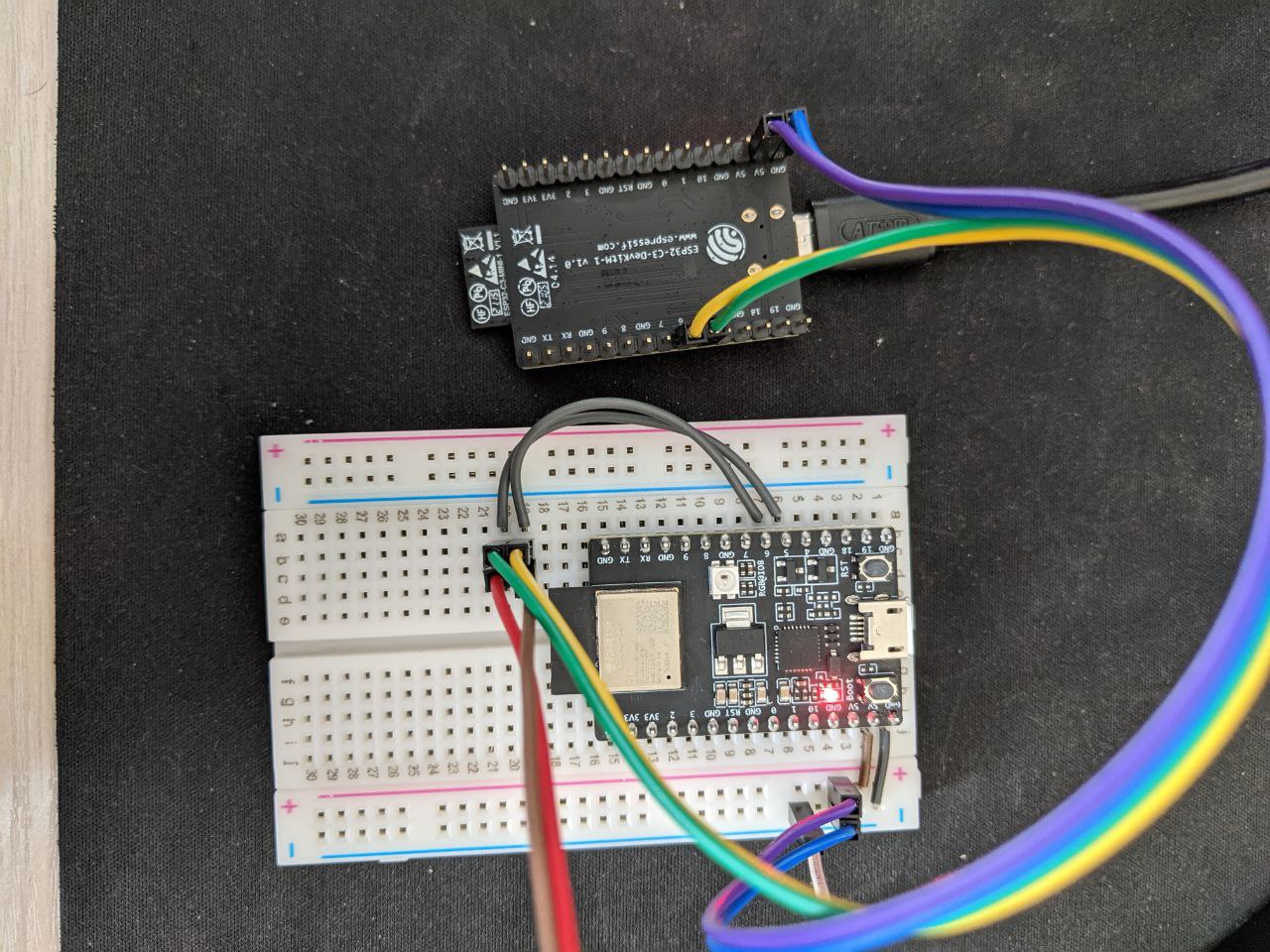

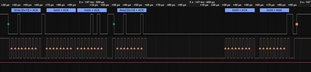

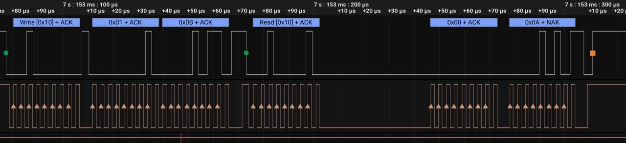

I'm trying to establish communication via i2c between 2 esp32 c3 devices. The idea is simple, I want to send non stop request to slave (with repeated start), where master write 2 bytes first and read data from slave. And it's working somehow but not in the way I expected because slave firstly run onRequest callback and then onReceive. This looks like a bug for me (correct me if I'm wrong)
As a result I'm receiving data from previous request...
Attaching my wiring and logic analyzer data for 2 requests

Logs:
Connected: true
// FIRST REQUEST //
First: 0
Second: 0
Func: 0
Register: 10
// END //
// SECOND REQUEST //
First: 0
Second: 10
Func: 1
Register: 11
// END //
