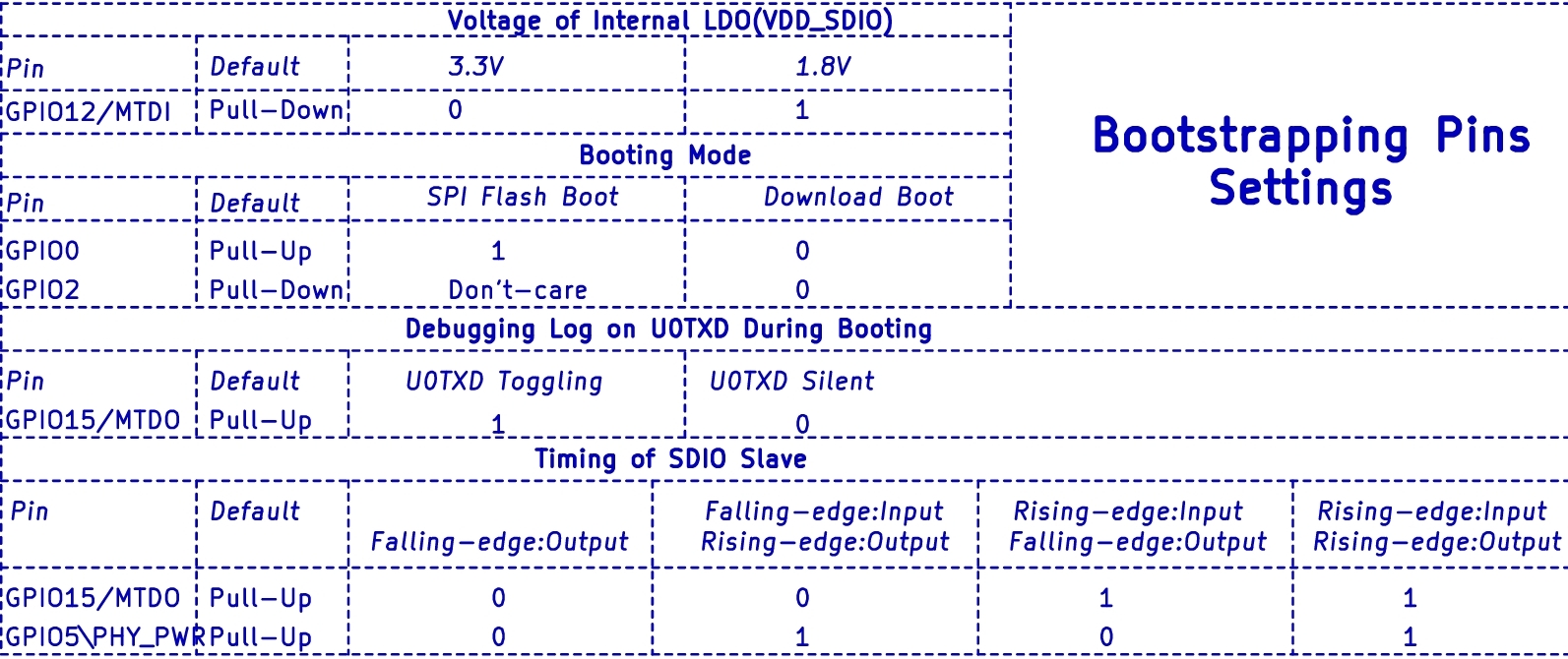

Postby marius.cezar18 » Wed Jun 01, 2022 6:33 pm
Maby help you!
SmartSelect_20220601-213211_Adobe Acrobat.jpg (554.35 KiB) Viewed 1491 times
