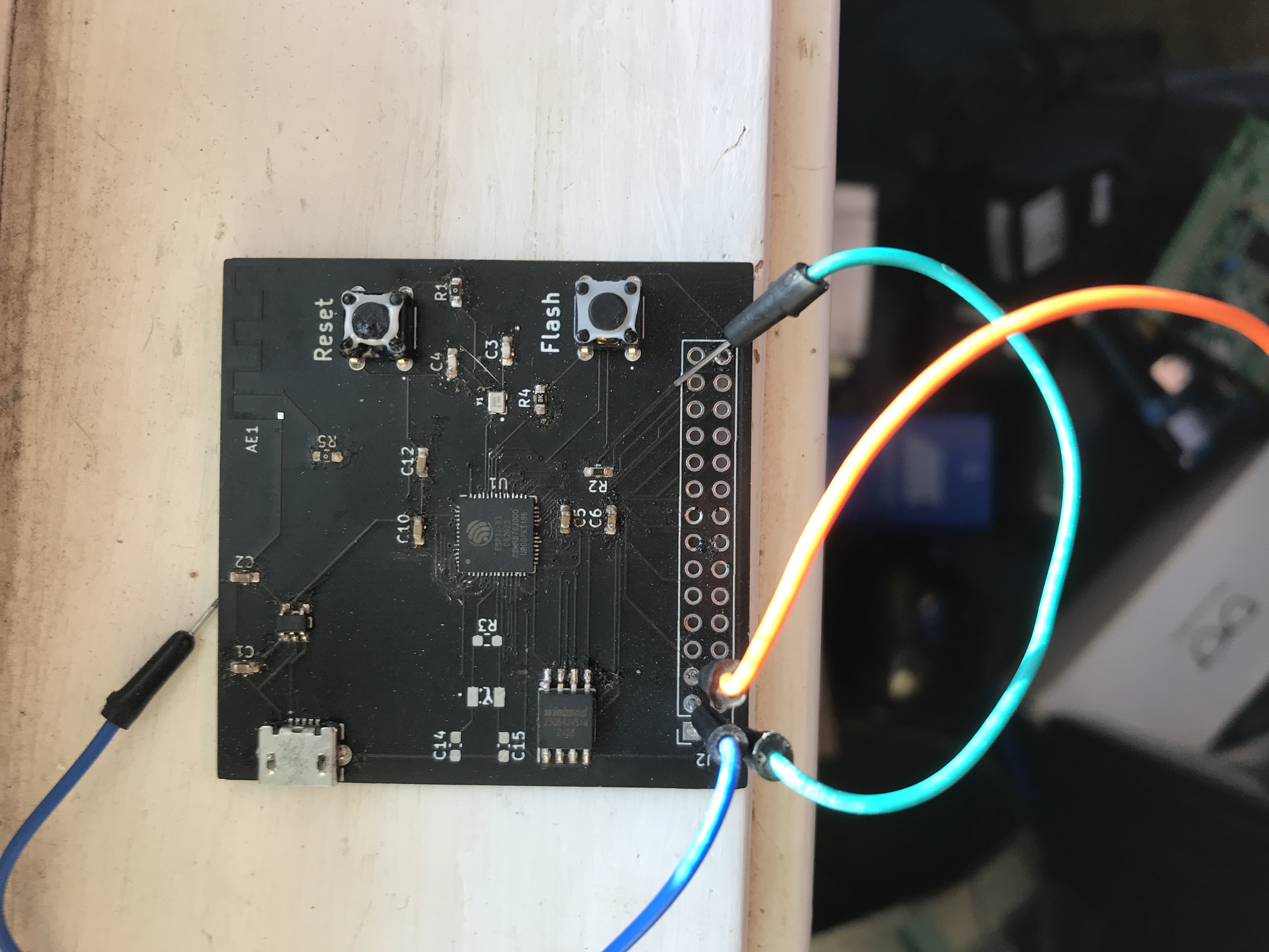

I honestly want to note that this could also be a soldering error or the fact I bought the chip from Digikey so here's a picture of my board:
The Image of my Board.
The board has a melted button, my bad, I solder using a hot air gun, and I kept readjusting the chip.
Or this could just be me messing things up.
If you can just help me through my stupidity that would be amazing.

Postby Sprite » Fri Jun 03, 2022 3:08 am
That is a slightly crunchy board :P but I see no obvious soldering issues.
Let's start debugging this.
- Always measure your rails. Do you get a steady 3.3V on the output of the LDO?
- You seem to be missing the capacitor for the RC network on the CHIP_PU pin. Can you add an 1uF capacitor from that pin to ground? It's probably easiest to solder it to R1. Note that R1 seems to be a 0-om link; you'd have to change that to the 10K indicated in the schematic as well.
- Do you have an oscilloscope or something to make sure you are getting a 40MHz signal from the crystal?
Btw, we also sell modules (like the ESP32-S3-Wroom series) that make it way, way easier to get a working devboard... especially getting the antenna stuff right can be Deeper Magic which those modules solve for you.

Postby UnknownBot » Fri Jun 03, 2022 2:09 pm
You're absolutely right! I need to take out the reset switch and put in the 1 UF Capacitor to create the RC Circuit! I'll do that in a bit...
Yeah, although, my board is less crunchy than the previous prototype. :shock:
Yes the pins always read the correct voltage, I've been tested that since day 1.
