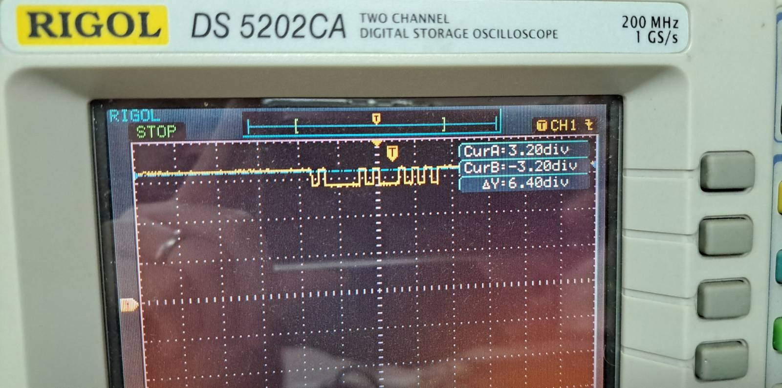

I'm using the We are using a ESP32-S3-DEVKITC-1-N8 with the uart connected to a SIM7600E.
I can see the TX from the ESP on the RXD of the SIM7600, but we see a signal on the ESP RX as follow:
The min is 2.84V.

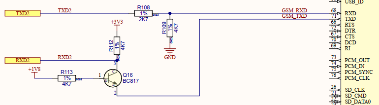

Postby Sprite » Tue May 31, 2022 3:36 pm
You have a voltage divider and level shifter in that schematic as if the ESP32-S3 were an 1.8V part. The ESP32-S3 is not an 1.8V part, so I'm scratching my head on why those components are there. Is the SIM7600 1.8V and you accidentally put the level shifting logic in backwards?

Postby Douglas-EDM » Wed Jun 01, 2022 9:33 am
Hi, I apologize for the unclear schematics. The IC on the right is the SIM7600.

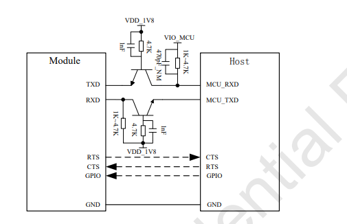

The SIM7600's UART is 1.8V.
For the TX of the sim7600 to the RX of the ESP we used the voltage level shifter as per the SIM7600 datasheet:
lvl shift.png (25.38 KiB) Viewed 7459 times
The problem is that the low bits to the ESP only pulls down to 2.8V instead of 0V while the high bits are at 3.3V as it should.

Postby Sprite » Fri Jun 03, 2022 2:27 am
Ah. The issue likely is that those pins are connected to the USB-serial converter on the devboard, and that is hard-pulling up your Rx line to 3.3V. Suggest you use different pins and a separate UART. The ESP series generally allow you to run an UART on any available GPIO pin: you can tell the Arduino driver which one you like by calling

We have moved the pins and it worked, we just wondered why that specific pins didn't work as it should.
