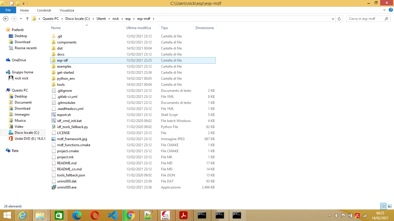

Hi to everyone,
I'm struggling one day in order to install correctly the ESP-MDF SDK with no success.
I have already esp-idf installed and running in my C:\%user%\esp
These are the steps I followed:
I did Step1 in https://github.com/espressif/esp-mdf
I did Step2 in https://github.com/espressif/esp-mdf : I have installed the toolchain by pointing it to my %user%/esp/esp-mdf folder
Step3: I'm blocked because I'm not understaing what to do here in [b][i]the https://docs.espressif.com/pr ... s [/i][/b]
I also attached my esp-mdf directory after toolchain download (step2) and the MDF_PATH query by cmd which results empty .
Could you please guide me in order to compile the get-started demo ?
Awaiting your kind reply,
thanks a lot.
Nicola

- Directory_ESP-MDF.png (137.25 KiB) Viewed 17067 times

Hi, I have solved by install everything in a Virtual machine.

How did you point your toolchain to the esp-mdf folder? I'm lost here. Also, any idea why my esp-mdf folder doesn't include an esp-idf subdirectory after cloning the esp-mdf environment from github?
