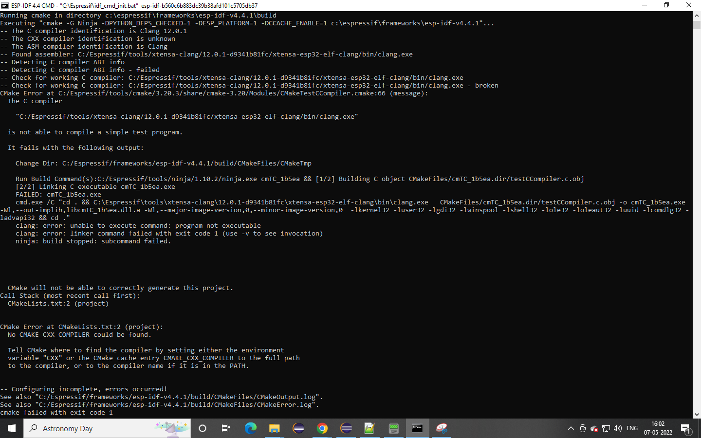

Presently am working on Eclipse IDE and am using ESP-IDF latest v4.4.1, when am trying to build all files after installation of tools, frameworks am getting error saying that "-- The CXX compiler identification is unknown" , below is the error message in ESP-IDF command prompt
Please suggest me correct solution to come out of these issue
Thanking you,
Suraj, N
