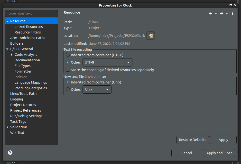

When I try to install these two of three modules/extensions ("Embedded C/C++ Core" and "Embedded C/C++ GDB JTAG Debugging"), I get the message that newer versions are already installed! Then what means this misleading message that these modules are to be installed!
A few days ago I noticed that the type "Build" was missing in the project properties. But I don't know if it's intentional or a mistake! So I can't check any build settings, also not the "OPENOCD_SCRIPTS"... See the attachment...
I've read again the chapter "OpenOCD Debugging" in the ESP-IDF manual for ESP32-S3 and changed the "Config options" to

In a new register in the middle window area with title "0x40000400" appears the message
Break at address "0x40000400" with no debug information available, or outside of program code.
with buttons "View Disassembly..." and "Preferences..." and the debugging is terminated.
What is going wrong now?
Screenshot at 2022-06-27 14-42-47.png (88.54 KiB) Viewed 7228 times
