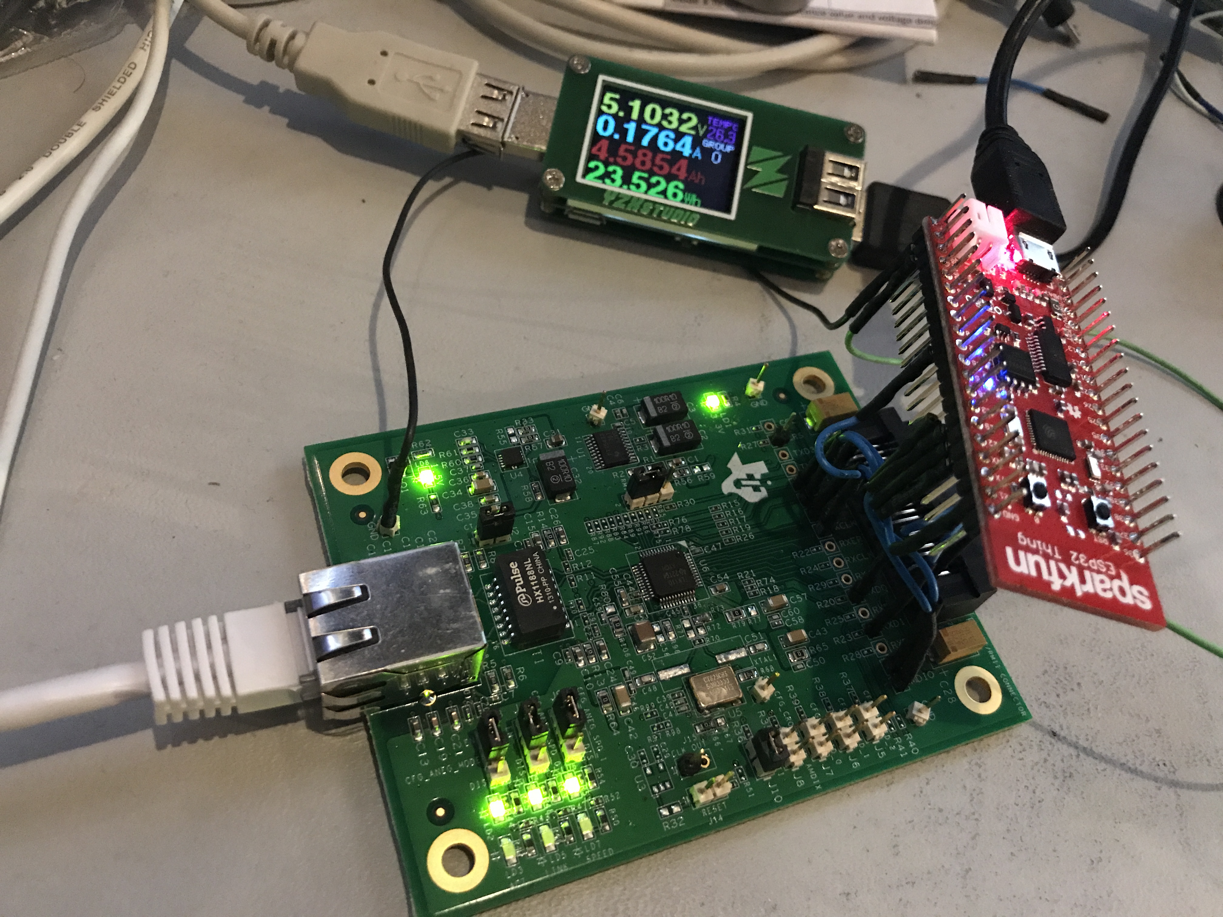

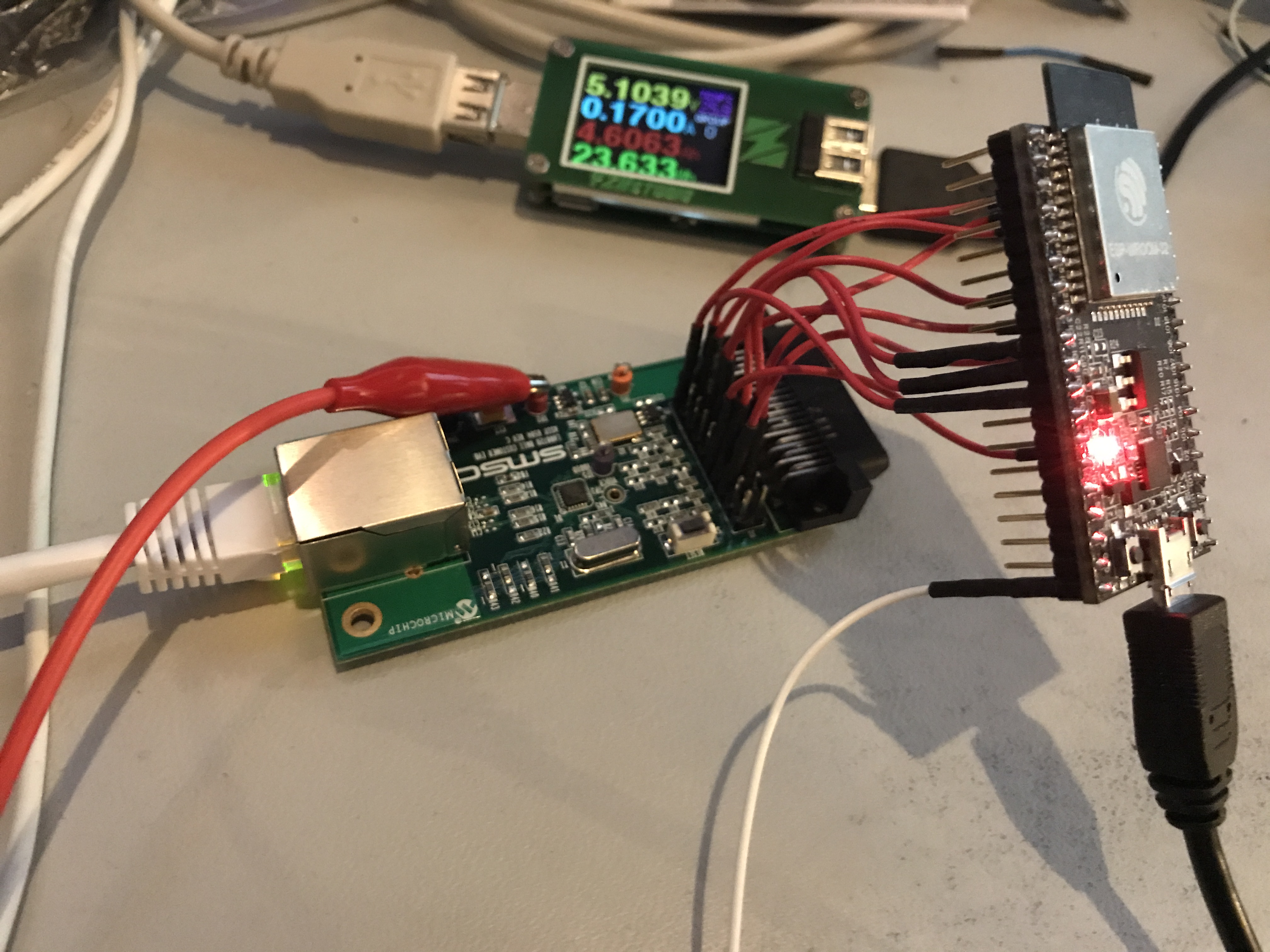

I have the Microchip/SMSC LAN8720A eval board wired up to the stock ESP32 dev board. No hardware changes were needed to the phy board. I duplicated the TLK110 functions for the 8720 and customized to match. The esp-idf source uses phy address 31 so I changed it to 0 for the 8720. The ESP32 sees the phy and talks to it without issue. I turned lwip debug on and see the DHCP packets transmitting and get the tx done signal. I scoped the rx lines and see the response packets coming back but the ESP32 never indicates that it received anything.
I also have the TLK110CUSEVM and modified it for RMII by removing the 25MHz crystal, R71, and R72. I placed a zero ohm resistor on R73 and added a 50MHz oscillator. With this config (modified for stock phy address 1), I'm able to get the same transmitted packets and no received packets, just like the 8720. Clearly there is some magic setting or hardware config that we don't know about.
It would be nice to get a response from Espressif.
TLK110 setup:
LAN8720A setup:

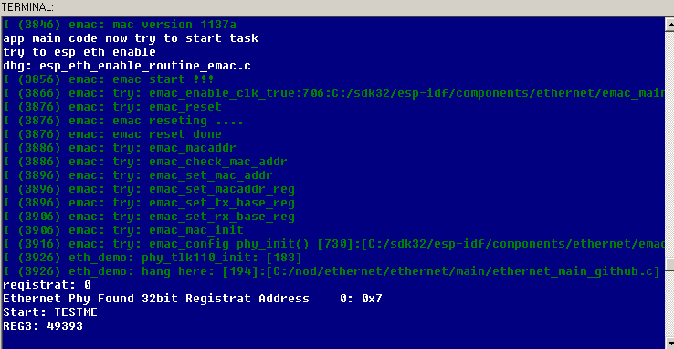

with one word, the SMI works here now too, phy is found, check Manufacturer Data ( Register 3 )

.. The esp-idf source uses phy address 31 so I changed it to 0 for the 8720.
hi robin
i have ordered the 150 EURO board too, but need a few days to arrival.
i use the LAN8720 Modul i get with express. i changed from 31 to PHY1 and phy is found,
on PHY0 there is no phy, can be, that the modul is fixed by resistor.
the SMI works fine. i missing few register must search on datasheet.

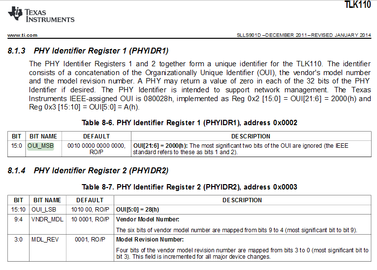

/*ok */ #define BASIC_MODE_STATUS_REG (0x0) // (0x1)
/*ok */ #define AUTO_NEGOTIATION_COMPLETE BIT(5)
/*ok */ #define LINK_STATUS BIT(2)
/*ok */ #define PHY_IDENTIFIER_REG (0x2)
/*new*/ #define PHY_IDENTIFIER1_REG (0x2)
/*new*/ #define PHY_IDENTIFIER2_REG (0x3)
/*old*/ #define OUI_MSB_21TO6_DEF 0x2000
/*new*/ #define OUI_MSB_LAN8720_DEF 0x7

I also have the TLK110CUSEVM and modified it for RMII by removing the 25MHz crystal, R71, and R72. I placed a zero ohm resistor on R73 and added a 50MHz oscillator. ...

Success on the tlk110!!! I ran the CRS pin from the eval board to the esp32 GPIO27.

I tried to do the same with the LAN8720 eval board but don't get CRS_DV asserted upon packet receipt. I'm checking config pins...

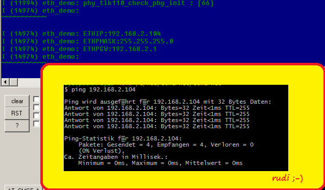

you are welcome ;-)
btw:
LAN8720 , PIN_CRS_DV on GPIO 27
static const char *TAG = "eth_demo";
#define PIN_PHY_POWER 17
#define PIN_SMI_MDC   23
#define PIN_SMI_MDIO  18
// LAN8720
#define PIN_CRS_DV    27
but we must check on the register / datasheet the things for

@www220
更改地址
#define PHY_STATUS_REG(0x1F)
#define AUTO_NEGTIATION_STATUS BIT(12)
#define DUPLEX_STATUS BIT(4)
#define SPEED_STATUS (2)
- >成功
谢谢!
Ethernet RMII
-> TLK110
-> SMS8720
-> LAN8720
-> LAN8720A
-> LAN8710
-> DP...
DONE!
best wishes!
