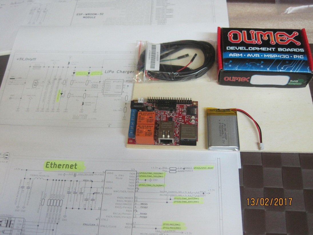

Re: EMAC receive not working
Hi Robin
thanks for feedback, ok I understand.
I wanted to exclude that you have not yet got ip.
So, then it depends on another place.
I do not know if you know it.
Olimex has released an ESP32-EVB RevA Board with Ethernet. The thing is opensource.
I have recently received one and are currently studying the circuit.
There are still a few things open but I think the approach is already good.
Where it is now exactly, will presumably write to the register.
Let's see what can be done. Will follow the thread and hold you up2date what happend and go on with this board this week.
rudi
Rudi, I looked at the olimex schematics (available on github) and they did some interesting things with function routing. Some of the choices they made are not per the pin/function specs of the ESP32. Have you tried the ethernet on your new board? It looks like CR1 is not populated and they are providing the RMII clock from the ESP32 GPIO16.
It looks like these boards are out of stock. I'm eager to get one when they are available.
Did they provide firmware that you can download into the board? I don't see the project firmware up on github so you might want to dump the flash to a file before you try to program it (if you haven't already done that).

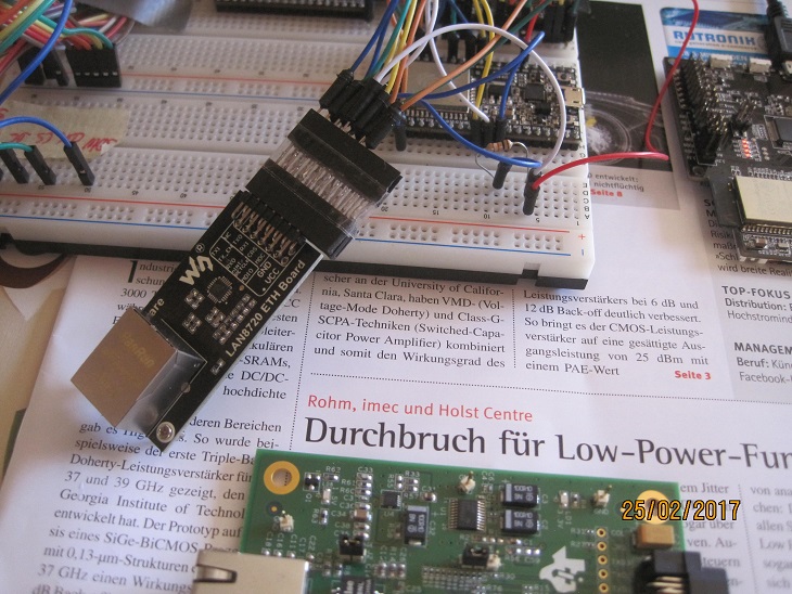

Hi Robin,
I am also working on this exact setup (esp32 and LAN8720). I'm trying to follow the same example on github but I'm not able to setup an ip address to ping the esp32. I was wondering if you had made any more progress on your end?
hi robin,
have found more small crazy "hang up" point without a return message...
one step it can be help for init the phy:
https://github.com/espressif/esp-idf/bl ... ain.c#L104
https://github.com/espressif/esp-idf/bl ... 0_phy.h#L5
can you check/test this:
get you the message "phy not found?"
i have more "debug lines inserted, cause we get on more steps no return, ( bad ethernet example code that does not run! )
which eval board you have from tlk110?
i use this tlk110:
btw: if you use the same, how you connect it, over pinheader or MII adpater?
we must change the xtal to 50 MHz for RMII Mode,
and hope you know this too:
just in time try the LAN8720
and try the LAN8710 ( olimex ESP32 EVB )
( here posted in the thread )
how you connect your pins from the board to the esp?
do you use pullups / pulldown on the lines?
on which?
how looks your header file for the LAN8720?
do you have short lines! ( under 10 cm )
cause it is hi speed!
btw, from where/what you use the 50MHz ( tlk110 ) board?
rudi

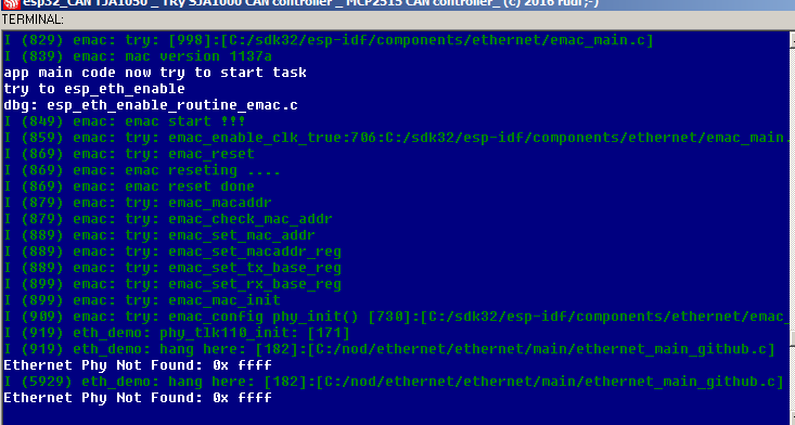

while (esp_eth_smi_read(PHY_IDENTIFIER_REG) != OUI_MSB_21TO6_DEF) { }Code: Select all
#define PHY_IDENTIFIER_REG (0x2)
#define OUI_MSB_21TO6_DEF 0x2000
void phy_tlk110_init(void)
uint32_t registrat = 0;
ESP_LOGI(TAG, "phy_tlk110_init: [%d]", __LINE__);
esp_eth_smi_write(PHY_RESET_CONTROL_REG, SOFTWARE_RESET);
8192 !!! ;-))))))
ESP_LOGI(TAG, "hang here: [%d]:[%s]", __LINE__, __FILE__);
printf("Ethernet Phy Not Found: 0x%5x\n\r", esp_eth_smi_read(registrat) );
// vTaskDelay(5000 / portTICK_PERIOD_MS);
if(registrat >= OUI_MSB_21TO6_DEF) {
ESP_LOGI(TAG, "nothing found 0..0x2000");
ESP_LOGI(TAG, "hang here now: [%d]:[%s]", __LINE__, __FILE__);
while(-1);
++registrat;
esp_eth_smi_write(SOFTWARE_STRAP_CONTROL_REG, DEFAULT_PHY_CONFIG |SW_STRAP_CONFIG_DONE);
ets_delay_us(300);
//if config.flow_ctrl_enable == true ,enable this
phy_enable_flow_ctrl();

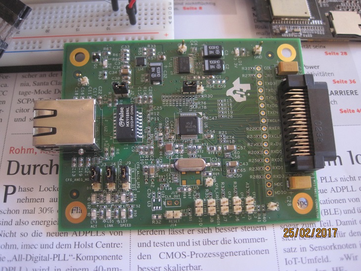

i use this tlk110:
added the note to the LAN8270.. Requesta note on tlk110
In the datasheet of the TLK110 under the description of "CLKOUT" it is written: "In RMII mode, this pin provides a 50MHz clock output. This feature allows other devices to use the reference clock from TLK110 without requiring additional clock sources."
be "warned"
CLKOUT on the TLK110 is simply a 50 MHz reference clock that doesn't have any timing relationship to the RMII signals. Therefore, it can not be used as the 50MHz RMII reference clock
it is tlk110 specification.
btw:
This issue has been highlighted ... errata will be updated with this item to ensure that customers understand that they should not use TLK110 50MHz output as RMII_REFCLK.
