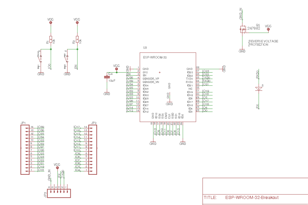

Im having a similar issue but cannot confirm it is power supply related in my case. I'm using the power supply and LiPO charge circuit taken off of the Sparkfun ESP32 Thing. I confirmed it is able to supply the WROOM by connecting to a ESP32 Dev Module 3V3 and Gnd pins directly. I am reading serial through a separate FTDI interface and confirmed it is able to run my WiFi examples without issue. However, when I try to run the WiFi.begin(ssid,pw) command on my simplified WROOM breakout, I get the same InstrFetchProhibited errors discussed here previously. Specific backtrace is here:

Also here is the schematic of my breakout circuit:
Any idea what's different? Perhaps I need a different capacitor closer to the input? Thank you!
