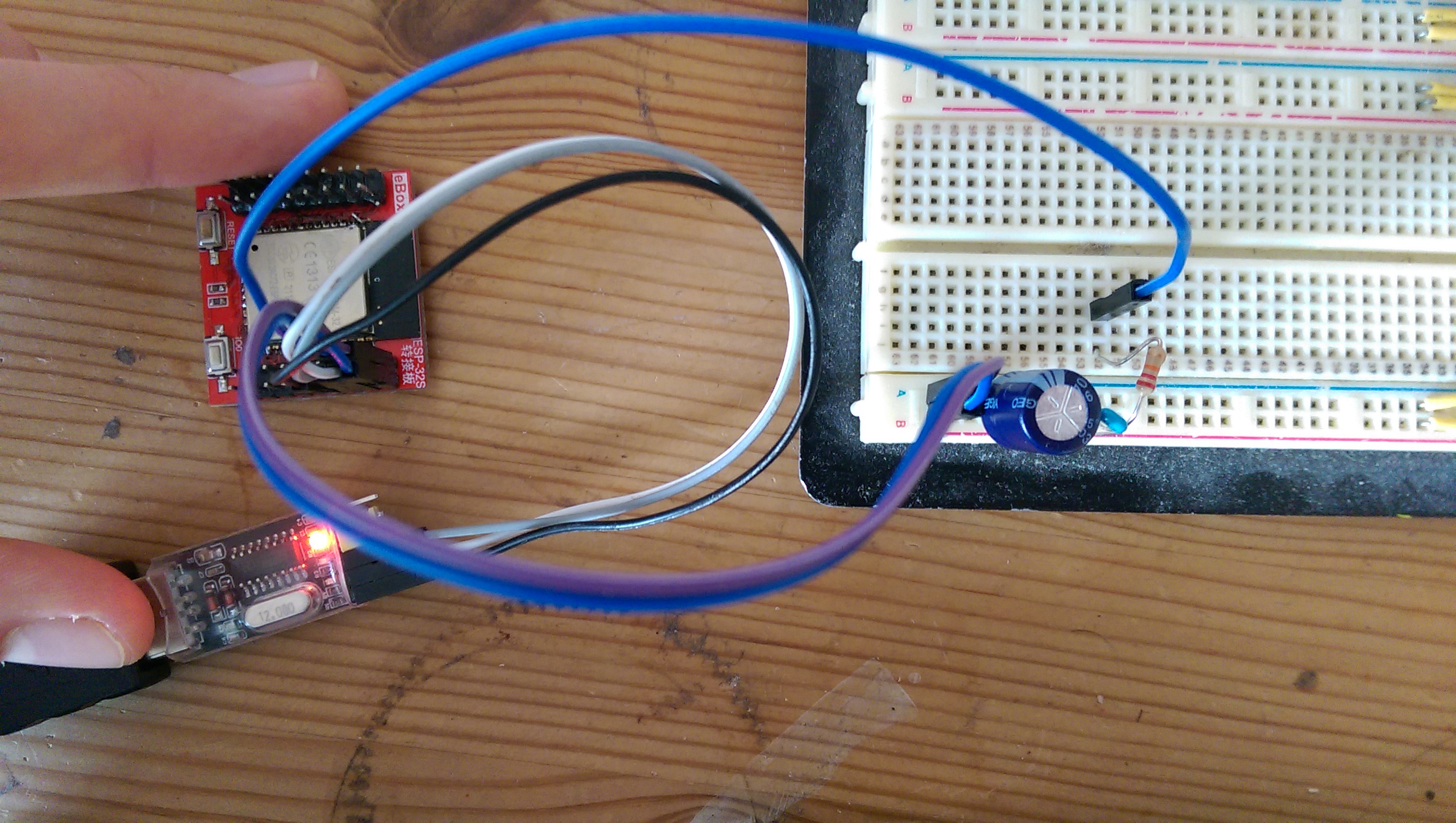

i spent the last couple of days trying to get any of the ESP32 Arduino examples to work. I got a ESP32 WROOM module on a simple breakout board. Connecting through standard USB->serial bridge. Circuit is very basic: EN pin connected via 22k to 3.3V, external power supply set to 3.3V, bunch of buffer capacitors, buttons for RST and GPIO0 on the breakoutboard.

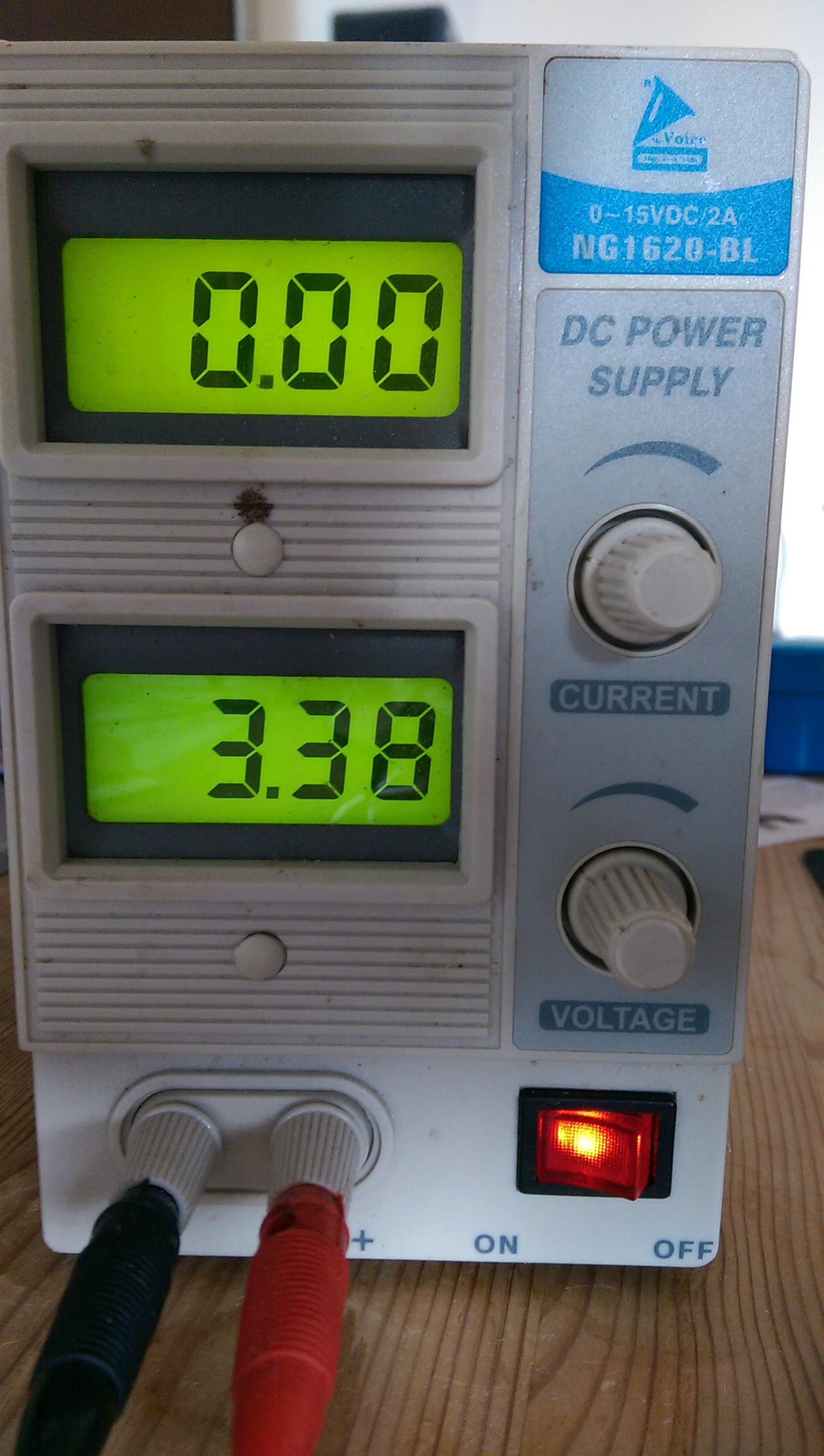

the power supply can deliver up to 2A @ 0-15V and is set to ~3.33V.
Power supply
Setup on breadboard is following: (Caps are 470uF and 100nF)
Breadboard setup
I also tried to solder the power pins directly to the power supply. Doesn't help. As i also tripple checked all solder pins of the ESP32 i think we can exclude any brownout issues. Also all my ESP8266's are happy with my setup.

Hans Dorn

Postby Hans Dorn » Tue Mar 14, 2017 11:18 pm
Electrolytics are rather slow
Try adding a 2.2µ film capacitor to your power rail.

Postby Angus » Wed Mar 15, 2017 3:15 am
To expand on Hans' answer, if you can solder a low ESR capacitor (ceramic or film or something else) very close to the power pins on the PCB then this may help - the combined resistance of the cables and the high ESR caps may not be responding fast enough to the current draw.
Similarly, if you can watch the voltage at the PCB end on an oscilloscope then you may see something helpful.

Postby maaaft » Wed Mar 15, 2017 7:11 pm
As suggested i tried again with one of those WIMA 2.2µF caps (see picture from Hans) directly soldered to the power pins of the ESP32. Unfortunately this didn't make any difference either - i still get the exact same error message from my initial post.
I'll bring the ESP32 to the Lab tomorrow and hook it up to the oscilloscope. Maybe this will help to bring light into the darkness..

Postby igrr » Wed Mar 22, 2017 2:27 pm
The numbers look reasonable, and the point where the crash happens indicates that this issue is indeed caused by current spike during RF power calibration (set_tx_gain_table). There is a chance that there is a bad solder joint somewhere, or indeed the wires from the module to the voltage regulator are too long. Most development boards have the regulator less than an inch from the module, which doesn't seem to be the case in the photo you have posted above.
