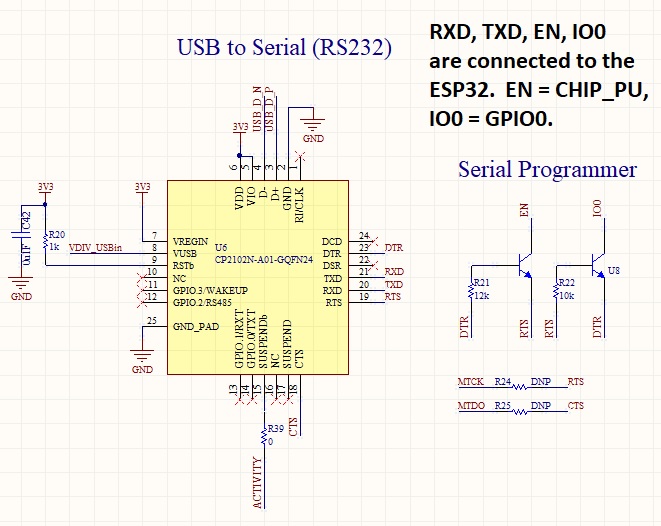

Can someone comment if the internal flash in the ESP32-D2WD is able to handle 3.3V or what is needed to adjust to allow the ESP32 to run at 3.3V? See the picture attached.

So I have cut the trace for VDD_SDIO and strapped the MTDI pin high. I see 1.8V on the VDD_SDIO pin which is a great start.
CP2102 interface.jpg (105.72 KiB) Viewed 13347 times

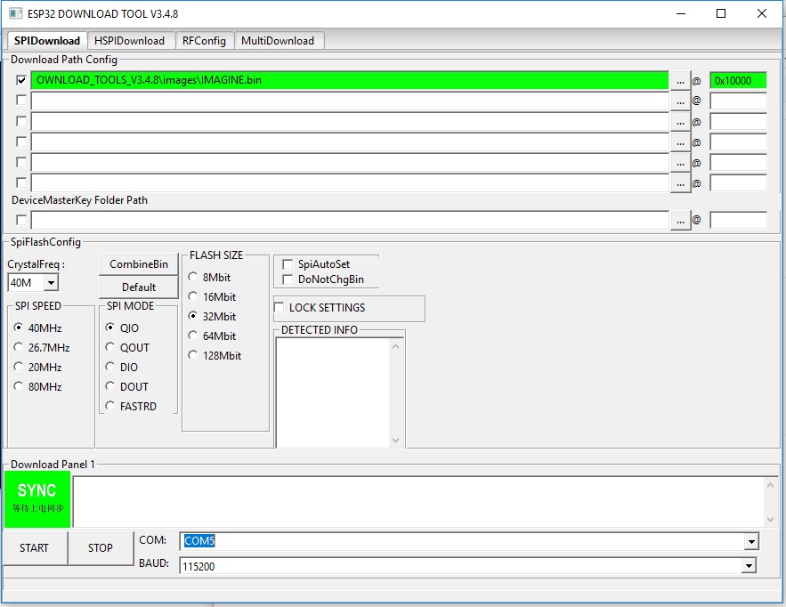

Now I just need to program the ESP32 with the Windows "ESP32 Download Tool, V3.4.8". Does anyone know what settings to use? My crystal is 40MHz on my PCB.

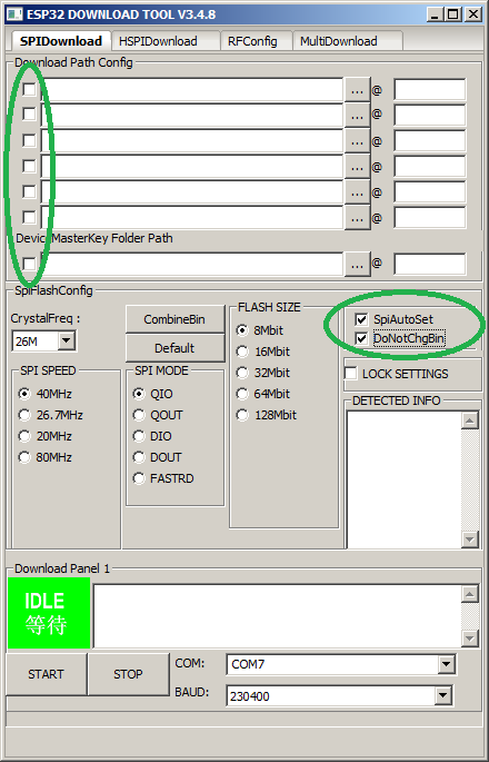

Postby rudi ;-) » Wed May 31, 2017 8:39 am
hi
you can run a simple test on it, deselect your firmware file
and select the auto like this:
the tool check your Flash too and will select for you the right
and you see the MAC, SPI Flash Info in the dedected info window after you push start.
( without a firmware upload )

Thank you very much for the recommendations and debug help. I found the problem. I had the wrong capacitor on the crystal so the crystal was not working. The CP2102 circuit above works great! n Again thank you!

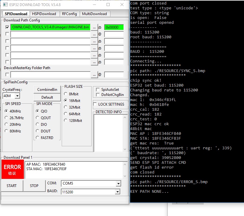

So I am using the ESP32-D2WD which has 16Mbits of flash internally. I can now see the MAC addresses but I am unable to program the internal flash. Can anyone see what the problem is? I have it set to QIO for the flash interface. Is that correct? Any speed recommendations for everything else? I have double checked the 3.3V power supply on an oscilloscope) and it is very good. It is solid the entire time the programmer is trying to program the flash so I know the 3.3V rail is not the problem. I have also tried different speeds for the COM port and SPI speed. I have also tried writing to different memory locations. Any help or advice would be great.

Posts: 1756
Re: VDD_SDIO for ESP32 D2WD
Postby rudi ;-) » Thu Jun 01, 2017 8:58 am
the ESP32-D2WD is the version of 16MBits eMbedded flash
and! 1.8V
for 1.8V you must use the bootstrap MTDI PIN to "high" -
have you checked VDD_SDIO for 1.8V too?
the SoC itself is 3.3V powered - this is ok, but don't forget to set bootstrap pin high for VDD_SDIO 1.8V
you can use eFuses too for this - for first settings i do proposal to use bootstrap pin.
it's the sure way
edit: ok - see that you have do the 1.8V bootstrap in your PCB - circuit
so next step, use the auto thing i posted a post before
and let set the flash tool the things automatic.
what is the output now?
