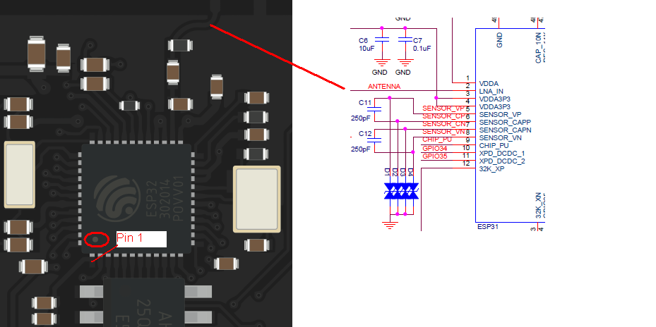

hope, espressif has not mounted the chip like this picture?
this would be not good :o
sorry
please check the chip position on picture :mrgreen:
think you must rotating the chip? or point pin 1 is wrong?
why an old chip from 2014 ? :ugeek:
have a look to this:
check it out!.PNG (67.23 KiB) Viewed 57755 times

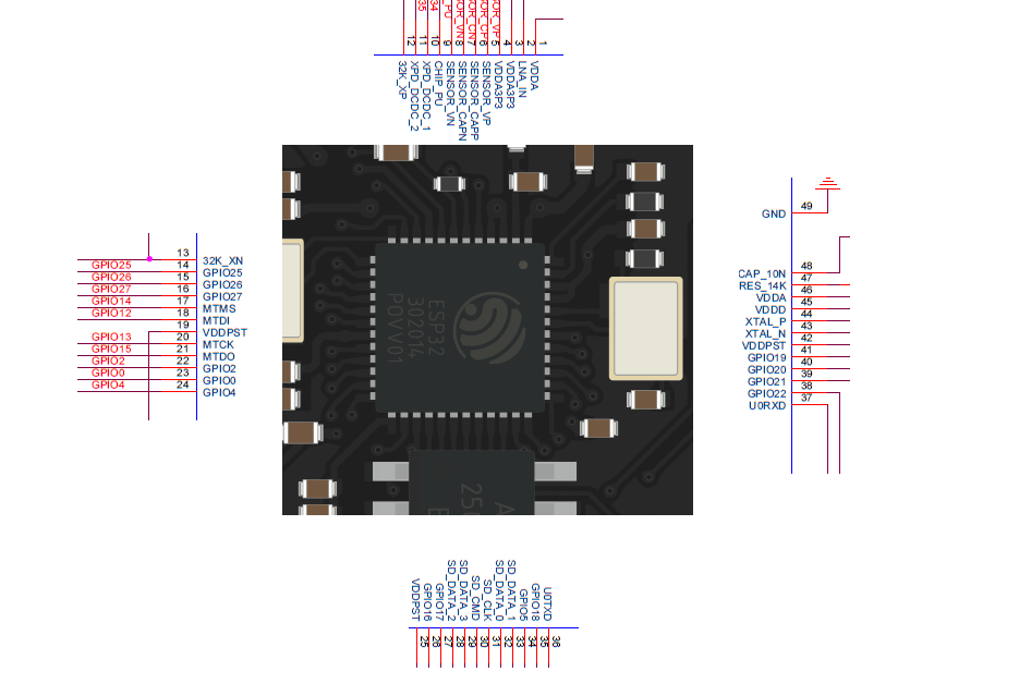

and have a look to your design
info:
the antenna pin on modul is is?
the pin 1 of chip is?
let us know your update asap,
rudi

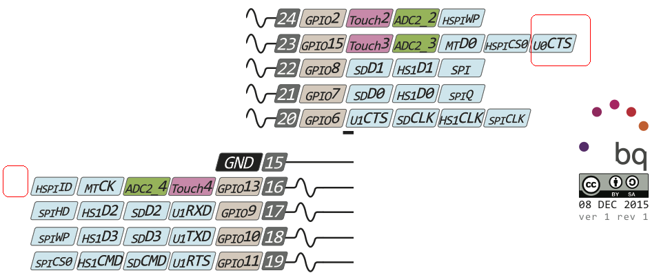

checked rev1.PNG (78.06 KiB) Viewed 57754 times
please have a control to the pin names too,
perhabs all fine - but controll it please.

sorry for the mistake I mean Espressif :D
I released a new version that fixes some bugs. Thanks for the feedback!

Hi Alberto
txs, can you please tell, which base you take?
john have linked yours here, so i am little confuse :)
http://esp32.com/viewtopic.php?f=2&t=14&#p107
perhabs he do not had valid only link to the pic.
because in some named connectors the name is difficult:
i can not controll all have no docu about - only the RTOS SDK 1.0 Src Code.
one example here can be controll and is showing here in the
base espressif RTOS SDK 1.0
SRC= https://github.com/espressif/ESP32_RTOS ... _mux_reg.h
take a look to GPIO 15 example:
#define PERIPHS_IO_MUX_MTDO_U (DR_REG_IO_MUX_BASE +0x3c)
#define FUNC_MTDO_U0RTS 3
#define FUNC_MTDO_GPIO15 2
#define FUNC_MTDO_HSPICS0 1
#define FUNC_MTDO_MTDO 0
we have U0RTS
The named pin is U0RTS
Your Pic shows U0CTS
btw
U0CTS is named in RTOS SDK 1.0
#define PERIPHS_IO_MUX_MTCK_U (DR_REG_IO_MUX_BASE +0x38)
#define FUNC_MTCK_U0CTS 3
#define FUNC_MTCK_GPIO13 2
#define FUNC_MTCK_HSPID 1
#define FUNC_MTCK_MTCK 0
that normaly must be PAD 16, ( GPIO13 ) but your pic shows no named pin for Uart0 CTS
have not controll all, but think there is a little mistake.
Which Base you take for naming the pads?
Because ;- ) we have Bounty Programm and perhabs the linked header file in RTOS SDK have a bug :o or yours :?

pighixxx
Posts: 9
Joined: Sun Dec 06, 2015 8:43 am
Re: [Documentation Release] PCB of ESP32 Module
Postby pighixxx » Wed Dec 09, 2015 8:08 am
Hi Rudy,
I double checked the info on my hands and yes, you're on right.
Preliminary information that I had was incorrect. Today I release a new pinout version enriched with new information.
