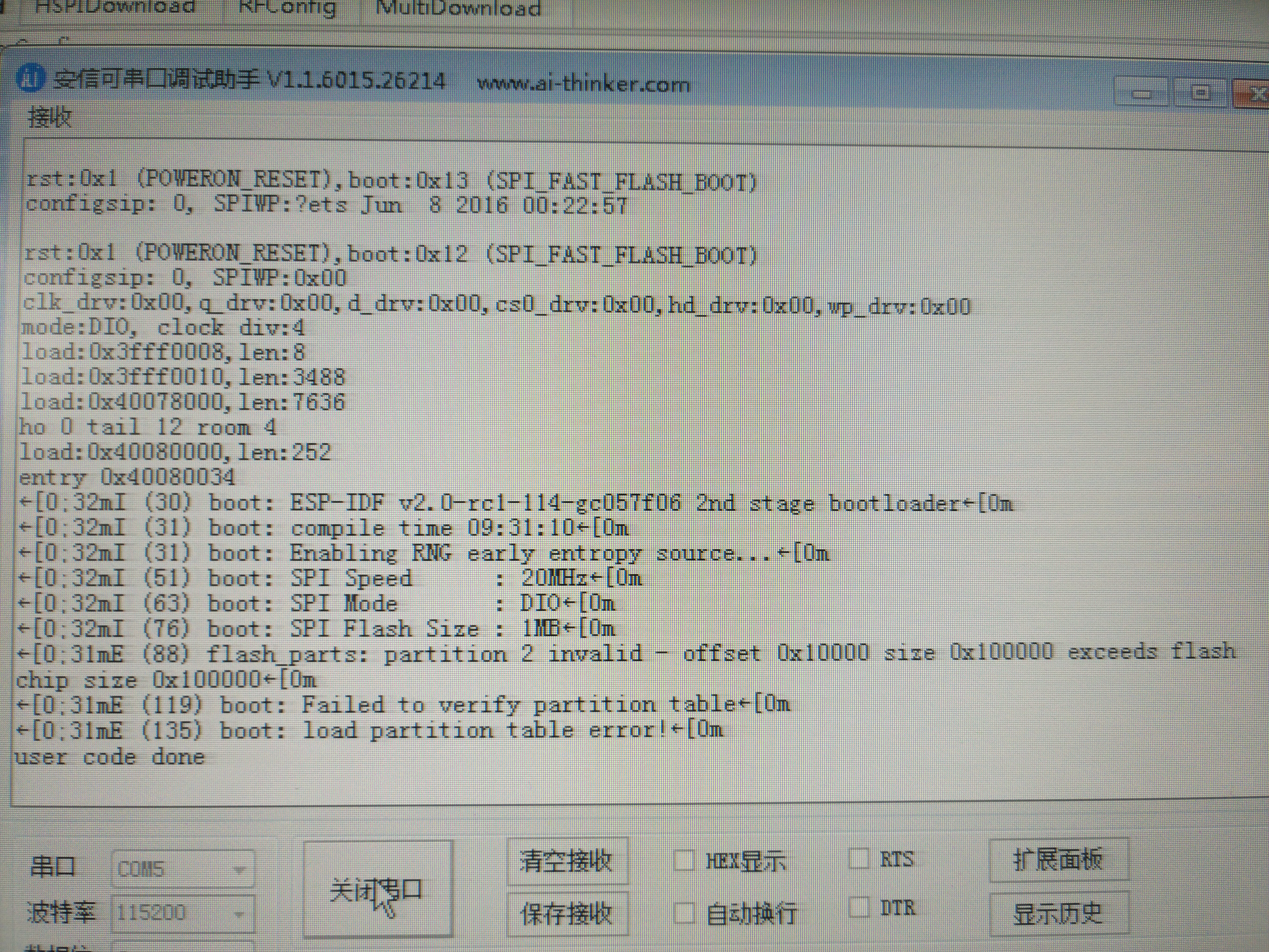

hi,we are now use the old verson IDF,as you say it can autodetective the xtal,so we download flash it well,but when we reset the chip,it print sth on the UART helper,maybe it doesn't run and stop at anyplace,i attch it below.Please help me and give some suggestion.

Seems like you don't have the partition table uploaded. Have you tried running 'make flash' to upload bootloader, partition table, and the application?
