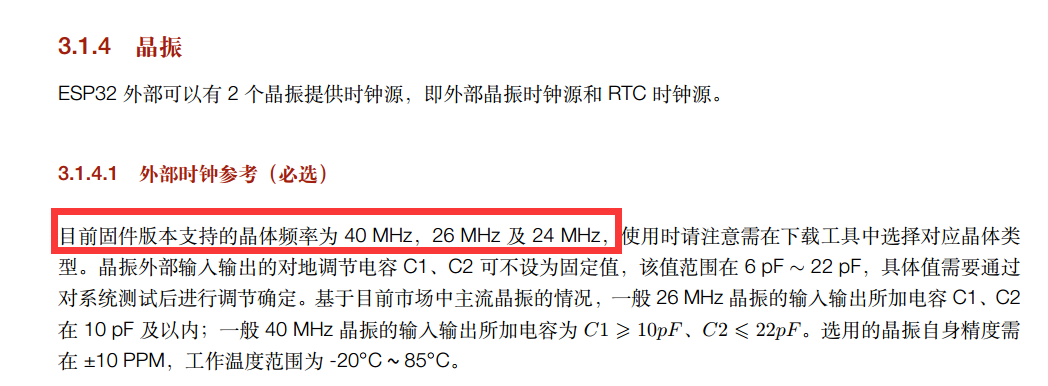

Hi,why the tech document said it suit 24M 26M and 40M crystal,but now you think only suit 26M and 40M.

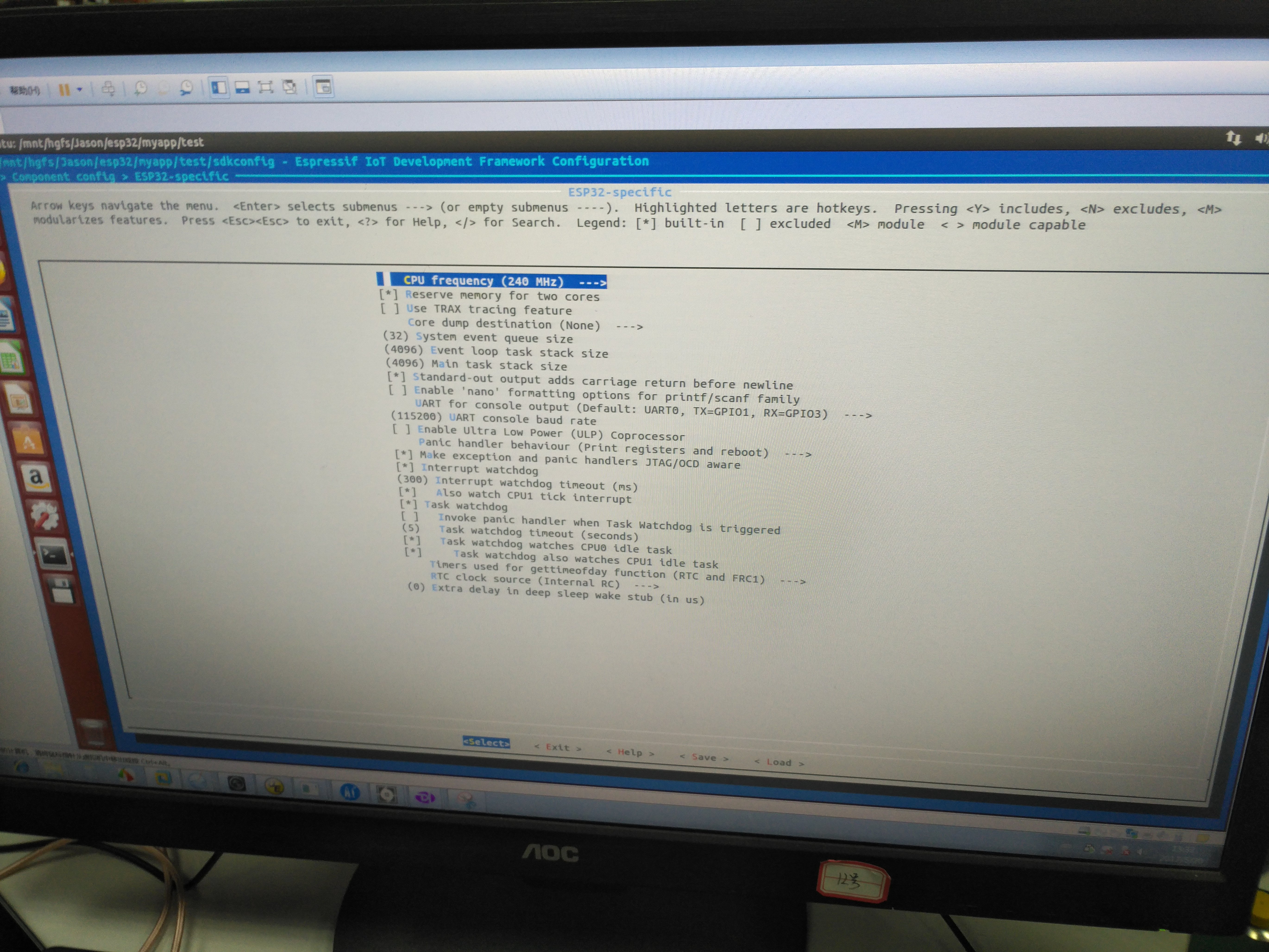

Now i post the picture,i want to ask where "Main XTAL frequency",could you please find it to me.We use the
IDF rc 2.0.
Thank you a lot :D .
The picture is in the attachments.

The chip does support 24MHz, and the software can be made to support 24MHz as well. However this isn't yet implemented because there wasn't sufficient demand for this. Your interest is noted and I will check about prioritizing this feature for the next release.
Choice between 26 and 40 MHz in menuconfig was implemented after 2.0 release. So in v2.0-rc1, v2.0-rc2, and v2.0 this feature is not available. You can get it if you use recent git version of ESP-IDF. Alternatively, if you wait a couple of weeks, it will be released in v2.1.

But why your tech document said that the esp32 support the24M 26M 40M.I think the tech document is correct and had be implemented.Now you said the 24M and 26M has yet implemented ,are you kidding? If the 24m and 26M has not implemented why your
tech document said the chip and software support them.
We had done a lot for the ESP32 according to your tech documents,but now we can't use the 24m and 26m.

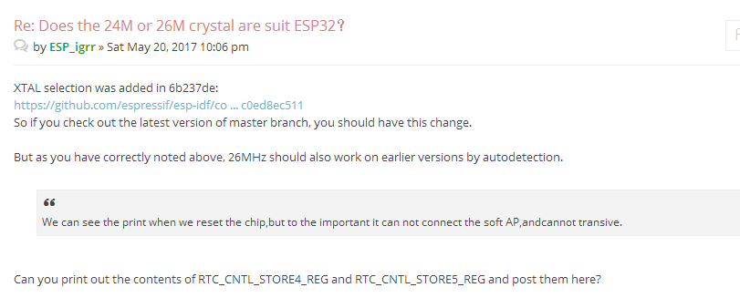

igrr
Posts: 2077
Re: Does the 24M or 26M crystal are suit ESP32?
Postby igrr » Sat May 20, 2017 2:06 pm
XTAL selection was added in 6b237de:
https://github.com/espressif/esp-idf/co ... c0ed8ec511
So if you check out the latest version of master branch, you should have this change.
But as you have correctly noted above, 26MHz should also work on earlier versions by autodetection.
We can see the print when we reset the chip,but to the important it can not connect the soft AP,andcannot transive.
Can you print out the contents of RTC_CNTL_STORE4_REG and RTC_CNTL_STORE5_REG and post them here?
