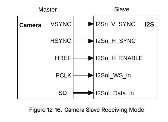

I had to do the following changes for slave mode (using external clock) on ESP32:
gpio_matrix_in(SD_CLOCK_PIN, I2S0I_WS_IN_IDX, false);
I2SX.conf.rx_slave_mod = 1;
//    logic_analyzer_ll_set_clock(sample_rate);
It seems to capture sd interface signals stable with 20 MHz clock.

on a side note via commenting
actually default values will be applied according the ESP32 technical reference manual. The default values are equivalent with these lines
   I2SX.clkm_conf.clkm_div_num = 4;
   I2SX.sample_rate_conf.rx_bck_div_num = 6;
... actually I don't get why does it work on 20 MHz in slave mode...

I haven't looked into slave mode in detail I can only assume that
I2SX.clkm_conf.clkm_div_num = 4; clk -> 160/4 = 40 mHz
I2SX.sample_rate_conf.rx_bck_div_num = 6; -> not used because you are feeding external clk to WS_IN, maybe 40 mHz is enough to steadily capture 20 mHz samples

Thanks a lot! It is a very useful hint that actually rx_bck_div_num is not used in parallel slave mode.
