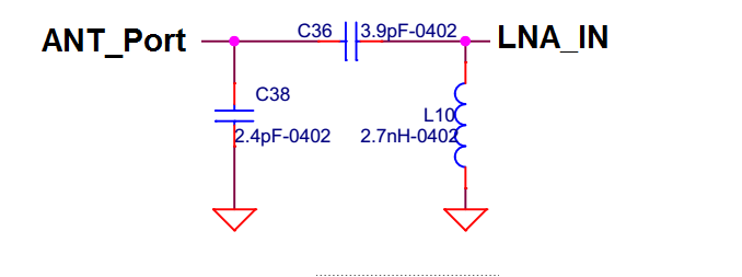

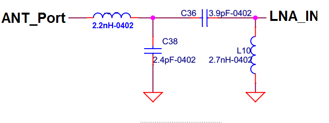

Did you see http://esp32.com/viewtopic.php?f=12&t=1060
What does your matching network look like?

I have attached both images: 1. Re commanded matching network but we didn't get TX output power and 2. Modified matching network to get proper TX Power.
Matching Network Image to get desired TX Power
Re commanded Matching Network Image
