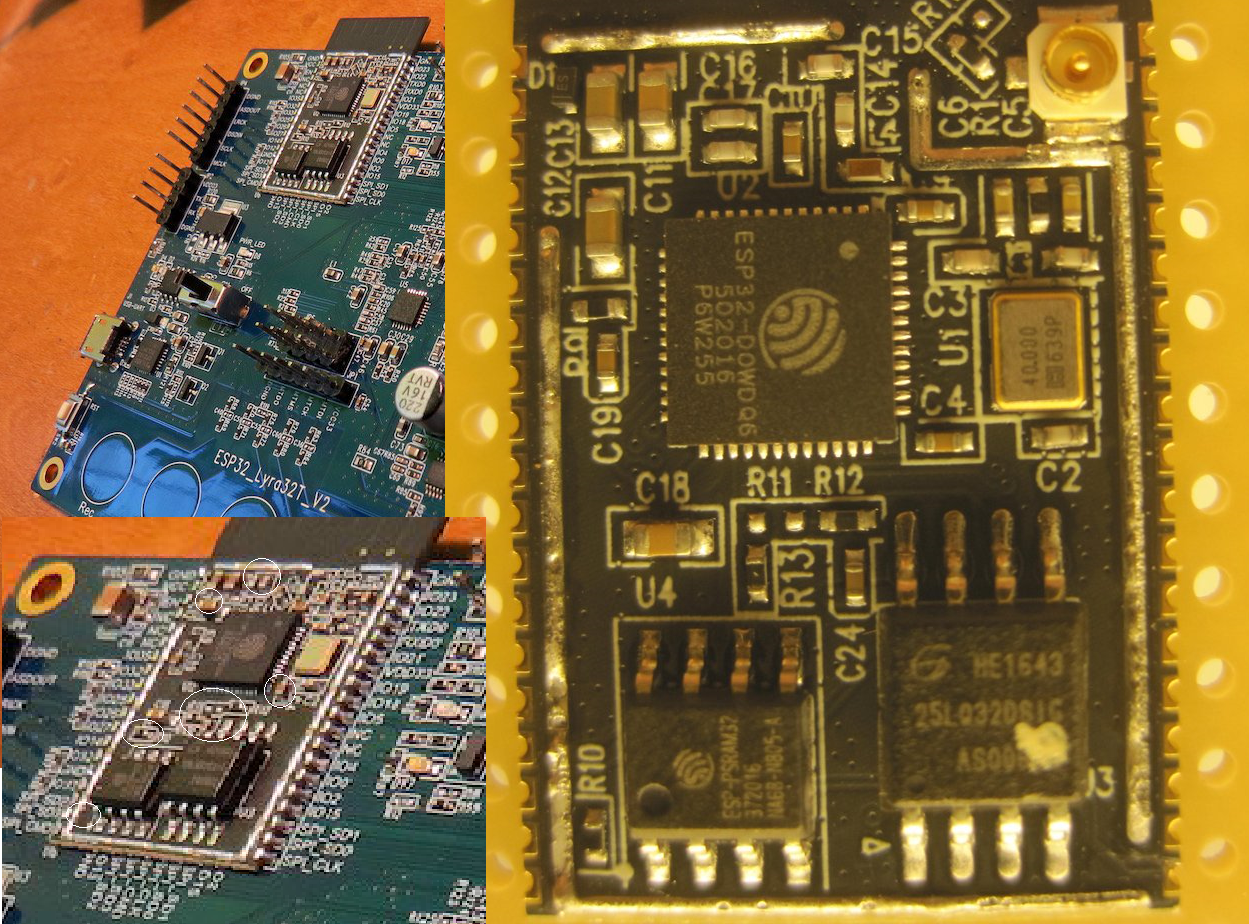

but I can post the schematic.
This pic doesn't show gpio12 pullup resistor
it was on side but perhabs on next side ( right side )
not sure is this important:

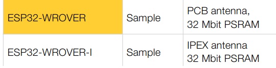

we have more as one versions of wrover
( ** not sure is this the same Rev/Version like in new Wrover Kit with Wrover Modul )
- the only one, that was shipped dez 2016 with IPX extern Antenn Con. ( Rev 0 Timestamp 502016 )
- the only one, that now on market on new Wrover Kit and without IPX, ( Rev 1 Timestamp 122017 )
( samples )
- ** the only one, that now comes as Wrover Modul with IPX ( new "batch" End August ) ( see Order Info )
- ** the only one, that now comes as Wrover Module without IPX ( new "batch" End August ) ( see Order Info )
rudi :-)

FWIW, I have versions with and without IPX here. The PCB is exactly the same (both have the PCB antenna as well as the footprint for the IPX connector), the difference is just in in the BOM.
Posts: 1759
Re: which new "esp" 8 pin ic is this on the new esp32 modul? ;-)
Postby rudi ;-) » Wed Jul 12, 2017 12:02 am
i think on Lyra Audio Board the Wrover is different. ( if you mean BOM = other Valu/Type - then ok - PCB is the same )
the Dez Version ( 502016 ) has as R9 4.7 K Ohm, the new Design 10 K Ohm - this BOM is different.

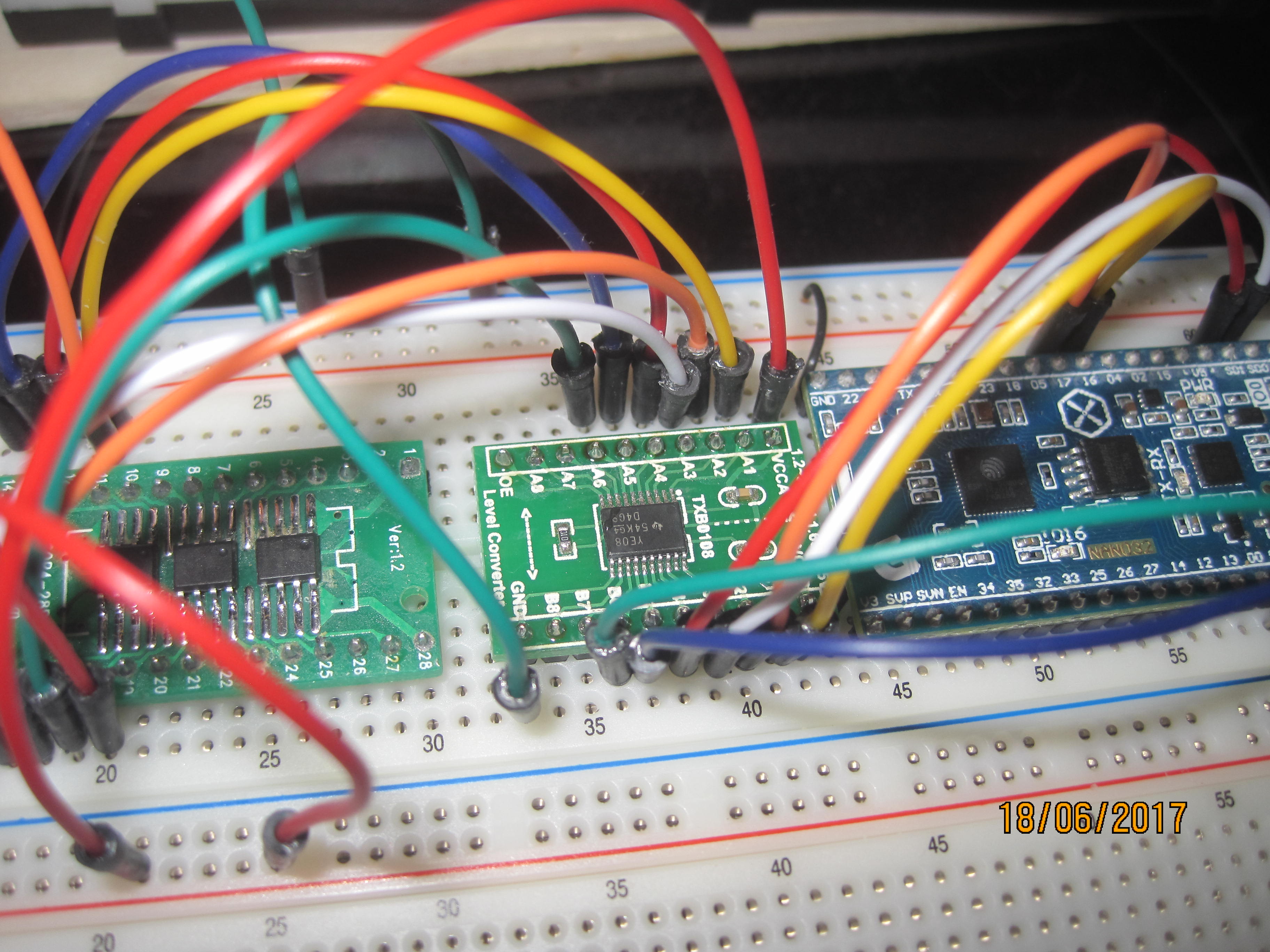

does psram 1.8 only work if flash is a specific flash and 1.8 too and VD_SDIO domain must set to 1.8 ?
i tried many things - many firmwares - many flashes - many hour's many days and now 2 weeks!
my hope was now TXB0108
DevKitC , 3.3V Flash
compile, SPI mode DIO
compile, SPI mode QIO
same with ESP32-Nano32-Gravitech, 3.3V Flash
LevelShifter 8bit bidirectional TXB0108
all lines
-SD0
-SD1
-SD2
-SD3
-SCLK
-/CE
/CE pulled up 1.8 V like shematic from WROVER you posted.
VDD 1.8 V
What interna secret do we know yet?
after successfull things
me comes over thinking measuring the pins from SoC / Flash to pinheader one time
and i was :oops: and :shock:
and i thinked again, that we do read the ID by simple 4 or 8 MHz SPI
so the Read ID was now successfull here too on this "long wire" way
so the long wire was not the reason to can not read the ID by simple SPI.
( Flash is 1.8 and MTDI was pulled up, VDD_SDIO 1.8 was wired ledout to the breadboard VCC row for connect PSRAM and so on )
the high speed theme on SPI ( 40 MHz ) is an other theme.
i think this can not be done by this wire - same is with the camera example.
we need short very short lineslike the Wroom32 mod with PSRAM
i will repeat this test with TXB0108 and 3.3 Flash again
also i will test now without TXB0108 and 3.3V Flash and 3.3V PSRAM 64Mbit next days.
i think i am not allone to missread the pinheader on Wroom32, Wrover, DevKitC, Nano32...
i post a picture, that says more as 1000 words, i am sure some guys will be :? too

Wrover Revision:
i think the Lyra Revision ( left side ) comes before the engineering version ( right side )
the engineering version has 4.7 K ( 4.667 ) Ohm as pull up for bootstrap.
i have not opened a wrover on wrover-kit with silicon Rev1 - but will do the next steps.
there must be then a 10 K Ohm resistor from hearing HRD.

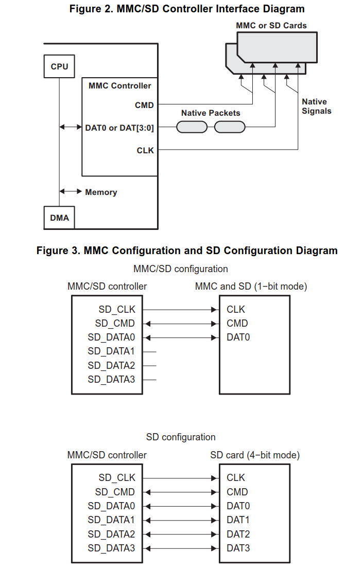

FYI ( SD_DATA0.. )
Side 12, 13, 14
sprufh5b.pdf
(372.24 KiB) Downloaded 669 times
