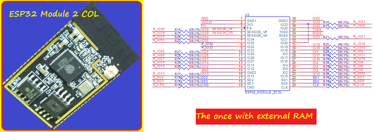

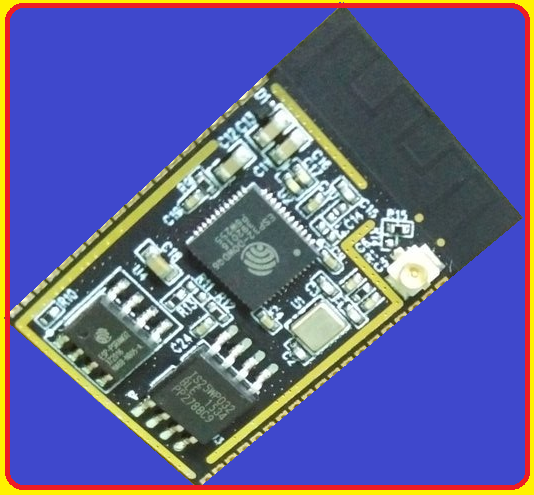

which new "esp" 8 pin ic is this on the new esp32 modul? ;-)
Posts: 1757
Postby rudi ;-) » Thu Dec 29, 2016 9:53 pm
hi guys
xmas was done :) hope you have celebrate a nice xmas party.
founds and question is hot, do you guys know about more of this ?new? esp :mrgreen: with 8 pin, produced 37 week 2016
modul spotted in the wild with ufl, 1.8 serial flash and the new 8 pin - ic with esp and espressif logo? 8-)
btw:
other 8 pin ic is serial flash IS25WP032
Datasheet
IS25WP032-064-128.pdf
(1.64 MiB) Downloaded 1139 times
Short: 1.8V SERIAL FLASH MEMORY WITH 133MHZ MULTI I/O SPI & QUAD I/O QPI DTR INTERFACE
src

hi guys,
the spotted new esp32 modul with external ram is noted in the shematic DevKitJ
ESP32-DevKitJ-v1_sch.pdf
(63.8 KiB) Downloaded 1068 times
Angus
Posts: 2344
Re: which new "esp" 8 pin ic is this on the new esp32 modul? ;-)
Postby Angus » Fri Dec 30, 2016 3:24 am
This is correct, the module is ESP32-WROVER and has external PSRAM.
ESP-WROVER-KIT is the other name for DevKitJ, it's designed to make use of this module.
Posts: 1757
Postby rudi ;-) » Fri Dec 30, 2016 3:37 am
hi Angnus,
txs, do you can "whisper",
is this "PSRAM" an own ESPRESSIF IC cause looks like espressif logo and begin is with "ESP" :mrgreen:
and have you the detailed name ( ESP-????? ) on the hand
Posts: 1757
Postby rudi ;-) » Fri Dec 30, 2016 3:56 am
got the identifers .. numb3rs
ESP-PSRAM32
372016
= produced 37 week in 2016
INFO
