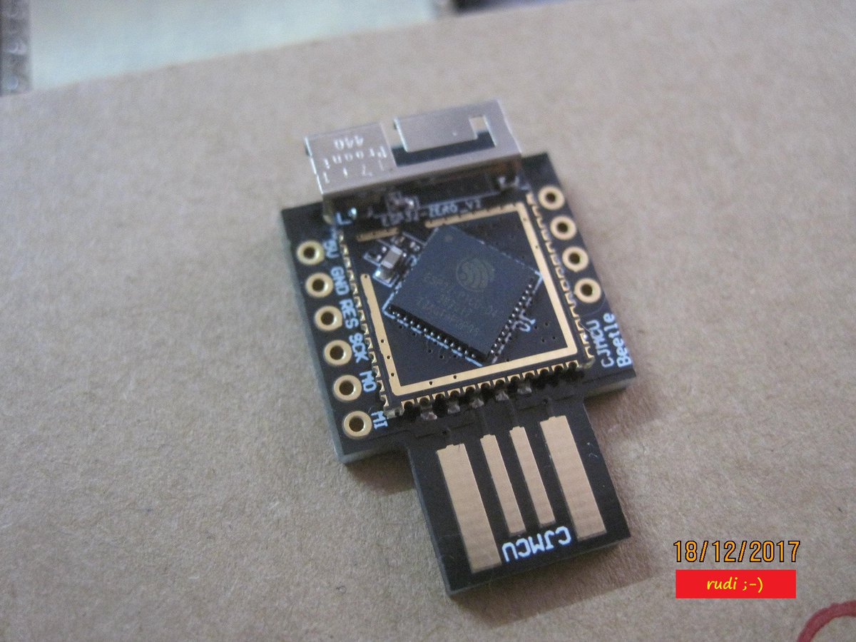

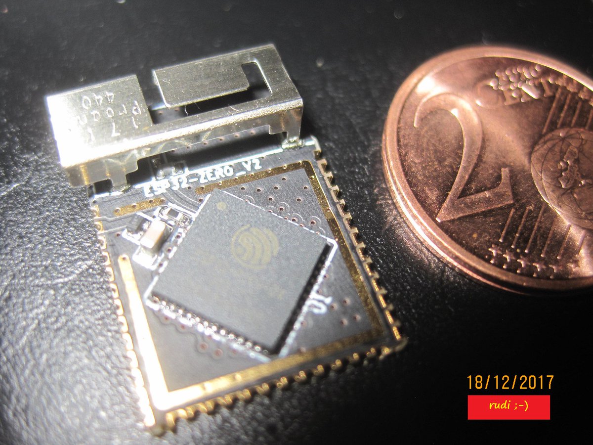

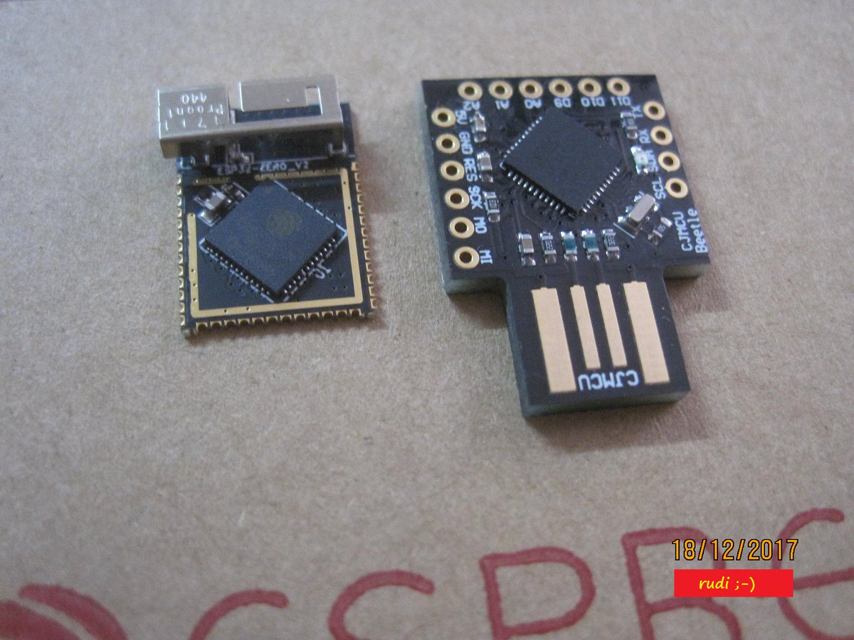

@loboris nice, txs, will try to get
btw, the engineering samples was from 2017
and i did combine with the "Beetle"

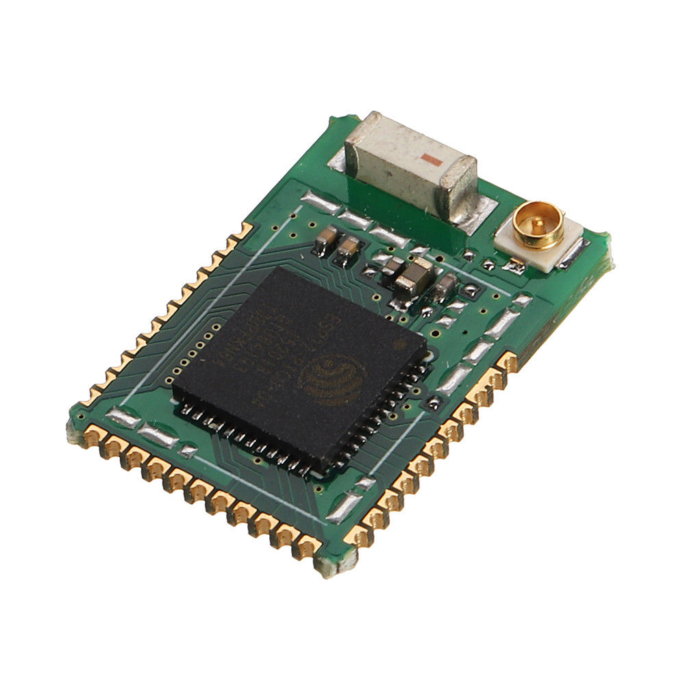

- TTGO-Micro-32_without_shield.jpg (93.36 KiB) Viewed 23943 times

TTGO Micro-32 Unfortunately doesn't have any certifications, so is good only for hobby brewery,
Plus looks bigger in size than Espressif's Engineering sample with the 3D antenna
Re: Small ESP32 Modul ( all include in new ESP32-PICO )
Even if you are using an RF certified module, your system (the final device) still will require testing. You will save money though, because it will require less testing than a full FCC / IC / CE certification of the underlying transmitter.
