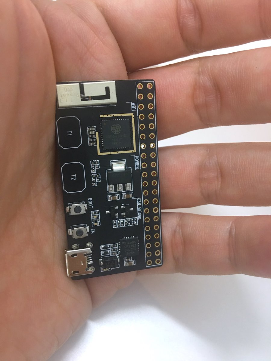

Hi Folks,
ESP32-P1CD ??
edit: it is PICO
Small ESP32 Modul ( all include )
without comment

Maybe ESP32-PICO-Q7
"Pico module" 7mm x 7mm

know a "modul" with embedded crystal and embedded flash(hope 128Mbit in esp32 pico ) from HF-SIP120
what you mean, is pSRAM included in pico too?
will it come as a regular product?
txs for your out flying wishes ;-)
edit: the pinheader of the board looks like raspberry pi zero ..
edit: yes it is pico i edit the head of post
edit: the tiny board is not for sale, but some folks get samples

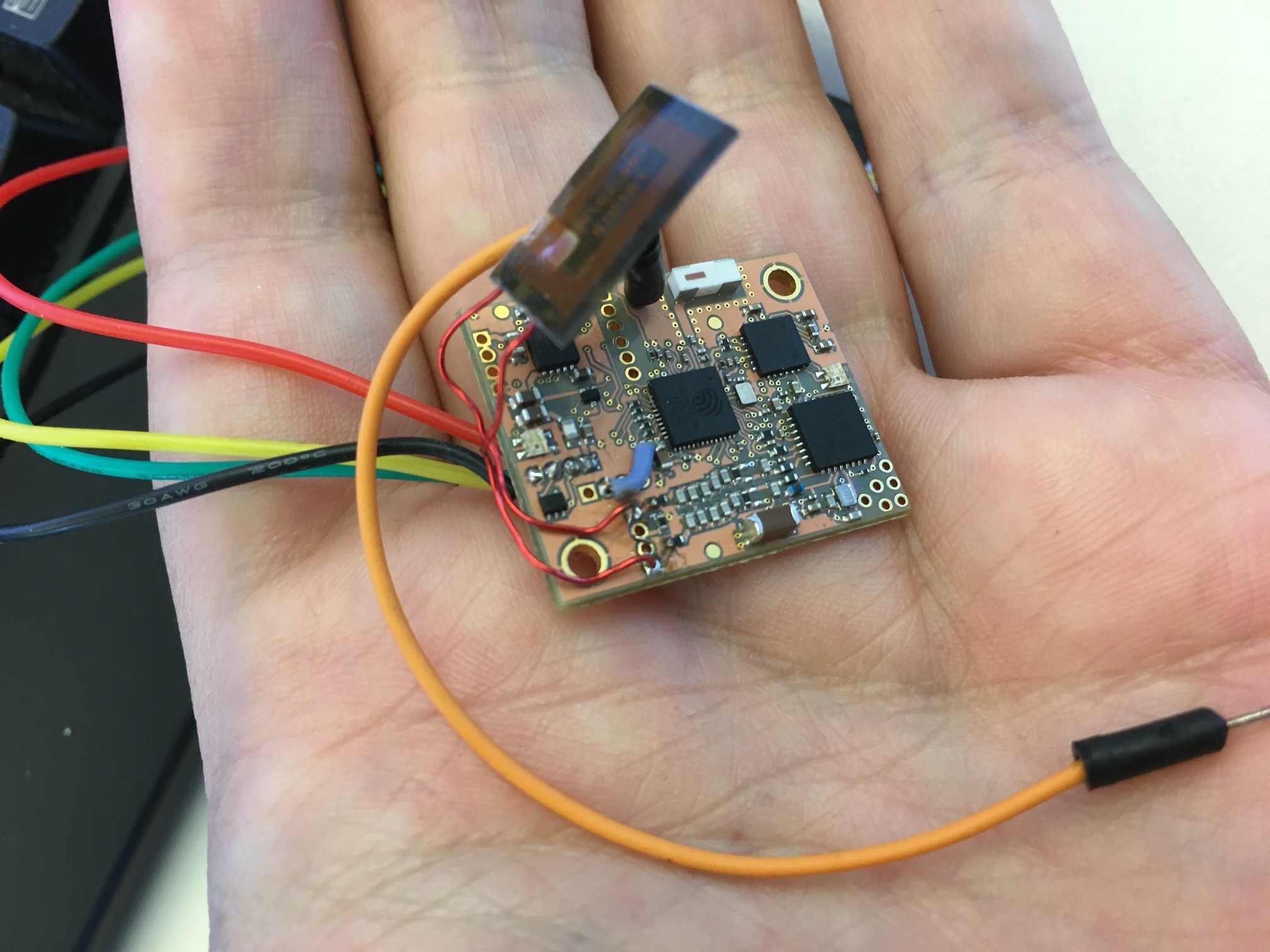

Small ?
;p
Here my version
ESP + LED DRIVER + 1.8v + 3.3v, plus I2C 1.8v->3.3v->1.8v plus battery managment. + RFID + RG Leds + FTDI + wifi antenna + Pedometer
Next version will be 30 % smaller.

I am in awe of you guys building such solutions ... I would love to read a blog article on how you go about the mechanics of this. Specifically, how are you attaching the ICs to the PCB? Are you soldering them yourselves? Is there a "service" that will assemble low volume modules such as these?

Yeah we used a company for a small batch pick and place. (15 boards)

Very nice! Well done!
Do you go to MP? Or where we can catch your nice Board ( like it )

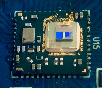

Not sure you have seen the "new ESP32-PICO Q7" on the "Small" :D ESP Modul,
the ESP32-PICO Q7 is a new ESP32 with all include in the SoC Package, OSC and Flash is include too.
it is a miniature ESP32 modul in a package.
if you can use in your next PCB that is 30% smaller you can save again place cause you did not need OSC and Flash example.
this was a prework of the ESP32-PICO Q7
the modul where the ESP32-PICO Q7 is mounted is "BIG" cause it is RPI (Raspbery PI) 2x20 2.54 RM form size

He is already using d2wd and tiny crystal and passives but PICO may save a few mm. NFC section looks biggest. Maybe "ESP-2018" will have built in NFC like rtl8711

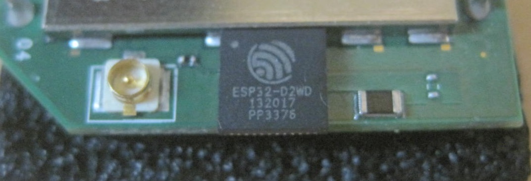

you're right,
i would use a small chip antenna in the meantime
( pic is for a size compare with an ESP32-D2WD - it's the right black from D2 )
edit: examples ( Products -> RF Antenna -> Chip Antenna )
ACA-2012-A1-CC-S super only 2.0x1.2x0.55 for 2.4G
ACM0-3216-A1-CC-S only 3.2x1.6x0.5 for GPS + 2.4G
ACM3-5036-A1-CC-S to big 5.0x3.6x0.7 for 2.4G + 5G
