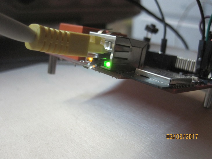

have plan to do on weekend, but could not wait:

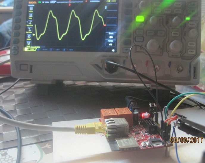

ESP32 generate 50 MHz for xRefer and X_in ( LAN8710A )
clk ok, SMI ok, now create the header for LAN8710A for DHCP and IP
( clk small curved cause have not filtered pinheader )
now we have

its the Olimex ESP32 EVB REV A Board
( edit: now we try to get the ip )
rudi

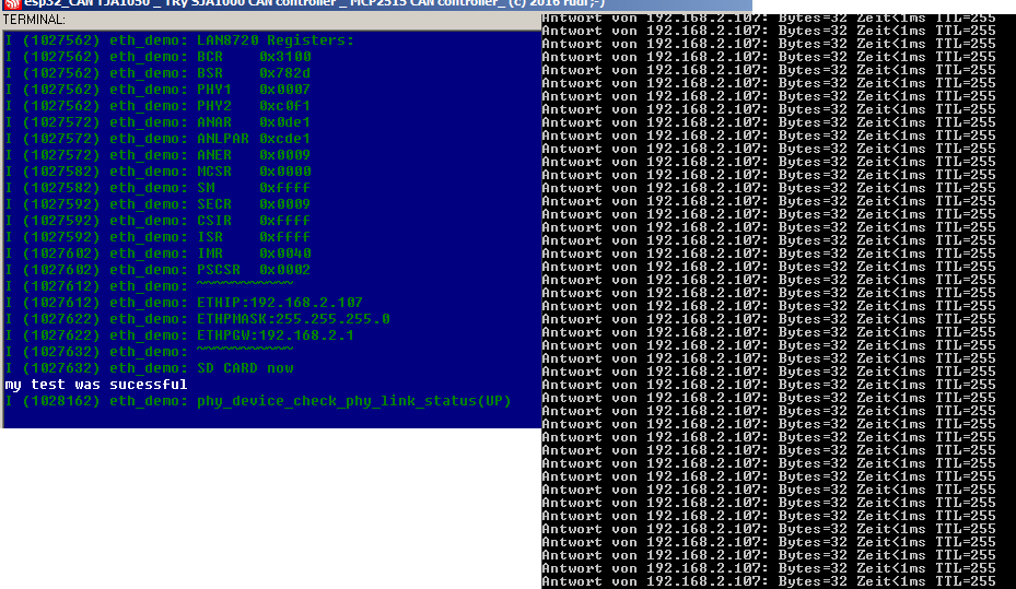

a big Yes
rudi
Re: EMAC receive not working
@www220
get the thing runing with Intern RMII Clk 50 MHz
sometimes i can ping, somtimes there is a long time for it.
sometimes i get no ip. i will try some things like delay's before each register change
and others.

from my test i can say, in general it is possible to create clk from esp,
to use it is sometimes difference and depending on the art of created "RTOS" process for it
To the comparison i will try this with the silicon rev1 again.
The clk itself is stable, I think the process PRIORITIES / creating claims a lot
So that only a few time slots remain for the processing for ip and ping answere.
Let's see what we can optimize together on the rtos
In the moment I use the external clk for project development and expansion and try to move it later intern rmii clk
rudi

clk sig is ok ( rigol )使用外部clk就涉及到gpio0冲突的问题,现在还没有什么完美的解决方案
mdc, mdio is ok, can read and set register
only i get no ip

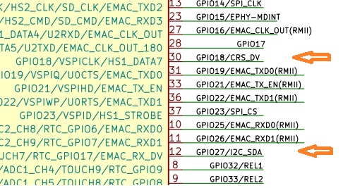

Have you verified the 8710 is working with an external crystal or oscillator? I didn't get an IP until I connected crs/dv to gpio27. Are you seeing the DHCP request on your server?
Robin
Robin
hi robinHave you verified the 8710 is working with an external crystal or oscillator? I didn't get an IP until I connected crs/dv to gpio27. Are you seeing the DHCP request on your server?
Robin
saw it
let you know how i get on the REV-A

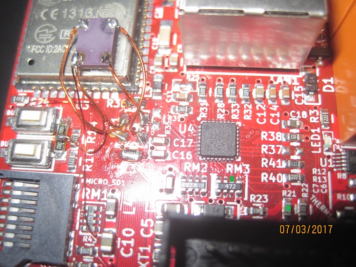

RM3- CRS_DV LAN8710A ..GPIO18
R21- FUNC_GPIO27_EMAC_RX_DV on it for using I2C pulled up and other ) best wishes
rudi

need few hacks/mods on EVB-REV-A
without words
rudi
