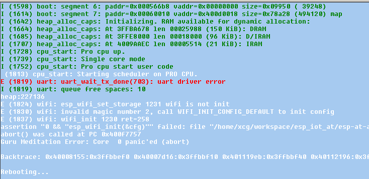

I think that the problem is the version of the esp-idf and esp-at-master example. the monitor console shows me:
E (1826) wifi: esp_wifi_set_storage 1230 wifi is not init
W (1832) wifi: wifi nvs_open fail ret=4353
E (1835) wifi: wifi_init 1191 ret=4353
assertion "0 && "esp_wifi_init(&cfg)"" failed: file "/home/xcg/workspace/esp_iot_at/esp-at-application/components/esp-at-core/./at_port.c", line 560, function: initialise_wifi
abort() was called at PC 0x400f732f
Guru Meditation Error: Core 0 panic'ed (abort)
And from what i could read in https://github.com/espressif/esp32-at/issues/6 and https://github.com/espressif/esp-idf/co ... a27e5bbdc7, a update may cause the problem. That's right?

Hi Rudi! Sorry for being late.
The SDK`s configuration that i was using was correct. The problem was that i used the Flash download tool, an somehow the phy_init was never validated when esp32 start running.
i tought that was a memory erase/write at download time, so i executed the command
make erase_flash
then upload the firmware an works perfect
thank you for the help!

this make me thinking:
/c/at_2036/esp32-at/sdkconfig:85:warning: symbol value '' invalid for PHY_DATA_OFFSET
update:
E (1825) wifi: esp_wifi_set_storage 1231 wifi is not init<\r><\n>
E (1831) wifi: invalid magic number 2, call WIFI_INIT_CONFIG_DEFAULT to init config<\r><\n>
E (1838) wifi: wifi_init 1230 ret=258<\r><\n>
assertion "0 && "esp_wifi_init(&cfg)"" failed: file "/home/xcg/workspace/esp_iot_at/esp-at-application/components/esp-at-core/./at_port.c", line 560, function: initialise_wifi<\r><\n>
abort() was called at PC 0x400f7757<\r><\n>
Guru Meditation Error: Core 0 panic'ed (abort)<\r><\n>
update:
cause the file:
is on the espressif developer pc, and AT is in the lib, we can not patch it.
we must wait for the support/patch from espressif developer "xcg"
perhabs it will be better, AT Lib goes open!
this closed things to libs is not good in open source and for debug!
you have to go back to the preview version of IDF SDK <7eaf1c76dc281c37075f8a8dac34cc3e09669f59> which it runs

i ran into the Guru meditation error too after upgrading from ESP-IDF 2.0rc1 to 2.0release.
the issue was a bug in the single-core mode. your issue looks the same.
See https://github.com/espressif/esp-idf/issues/496
