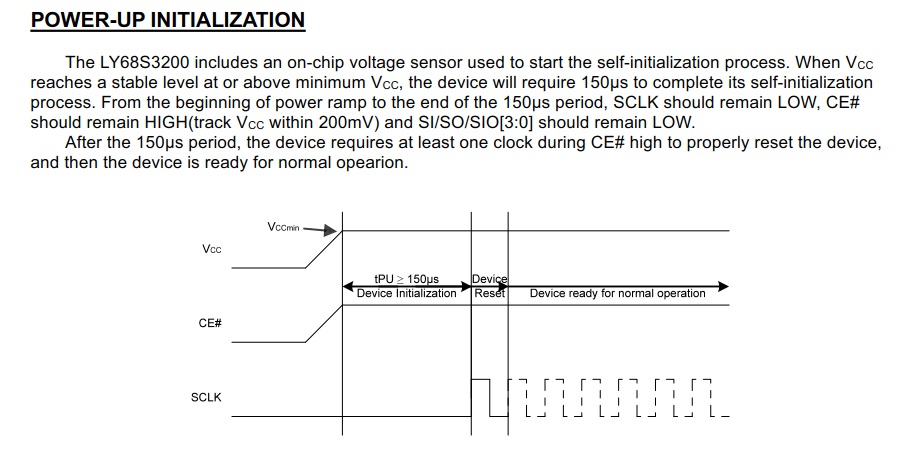

POWER-UP INITIALIZATION
Taken from the Lyontek Datasheet: LY68S3200SL and is of the same kind in Initial to ESP-pSRAM32 (2017.01 V1.0 Initial release)

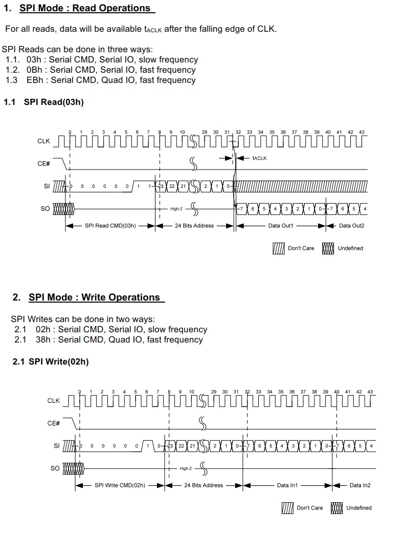

SPI READ and WRITE
with one difference, the 0x02 CMD for write is right in the Lyontek Pic
feel free to append your information to handle the pSRAM or compare with the free available datasheet of LY68S3200SL, this helped me now to know, that there is a POWER-UP INITIALIZATION need and a HIGH CLK for Reset and Ready need - the information was free available. the datasheet upload is on the follow post, cause only 3 attachments allowed.

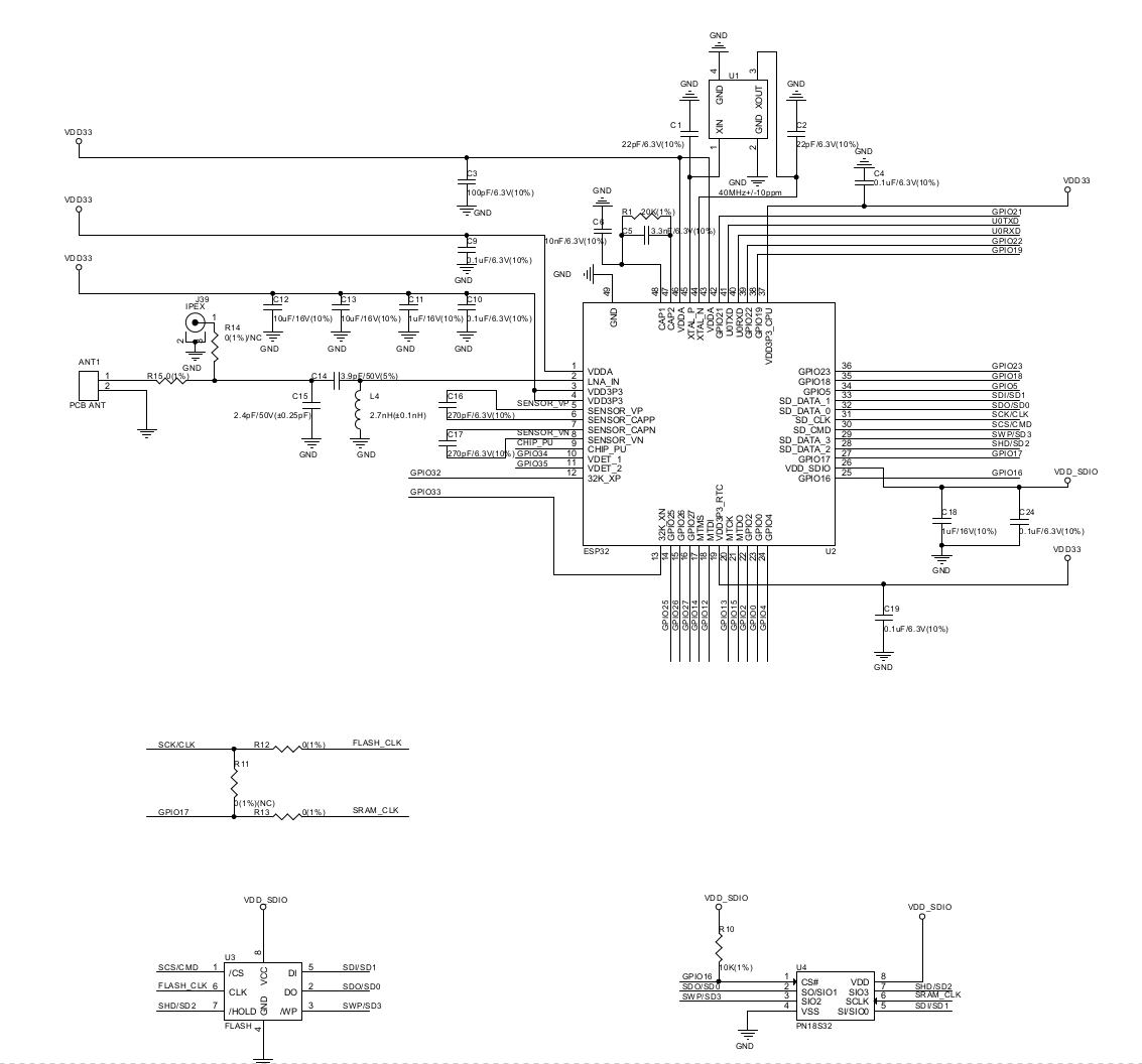

This is correct, the module is ESP32-WROVER and has external PSRAM.
ESP-WROVER-KIT is the other name for DevKitJ, it's designed to make use of this module.
Hi, Can you show us the schematic of esp32-wrover? We want to know how to connect PSRAM and Flash.
Thanks
ESP32 Chip, Module, Development board! Go: [url]https://analoglamb.com/[/url]
Re: which new "esp" 8 pin ic is this on the new esp32 modul? ;-)
Rudi: The pages you mention are MMU pages; they're inherent to the way the ESP32 maps the external RAM into main memory and not a property of the RAM chip itself. Also, the routines to do SPI memory copies seemingly slipped through the review process: the code needs to be cleaned up, if anything. Feel free to use it if you want but please do not assume the API is stable; we may change it when we get around to properly reviewing it.
AnalogLamb: The Wrover datasheet isn't public yet (because officially the wrover isn't a product we have announced as for sale yet, from what I can infer) but I can post the schematic. If you need more info, please contact Espressif privately.
- wrover-schem.png (100.08 KiB) Viewed 14456 times

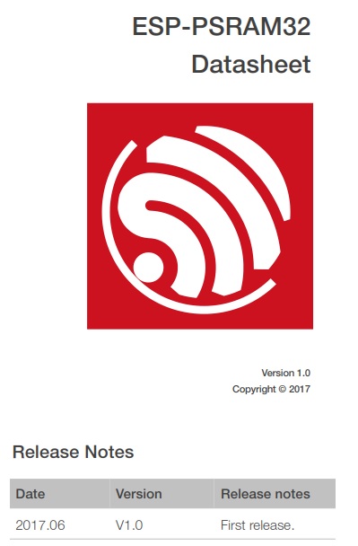

txs jeroen.
btw,
now the espressif psram datasheet official online.
Release 1.0
Date: 2017 June 5
here as attachment here as link from the docu resource
visit the docu resource
rudi

This pic doesn't show gpio12 pullup resistorbut I can post the schematic.
