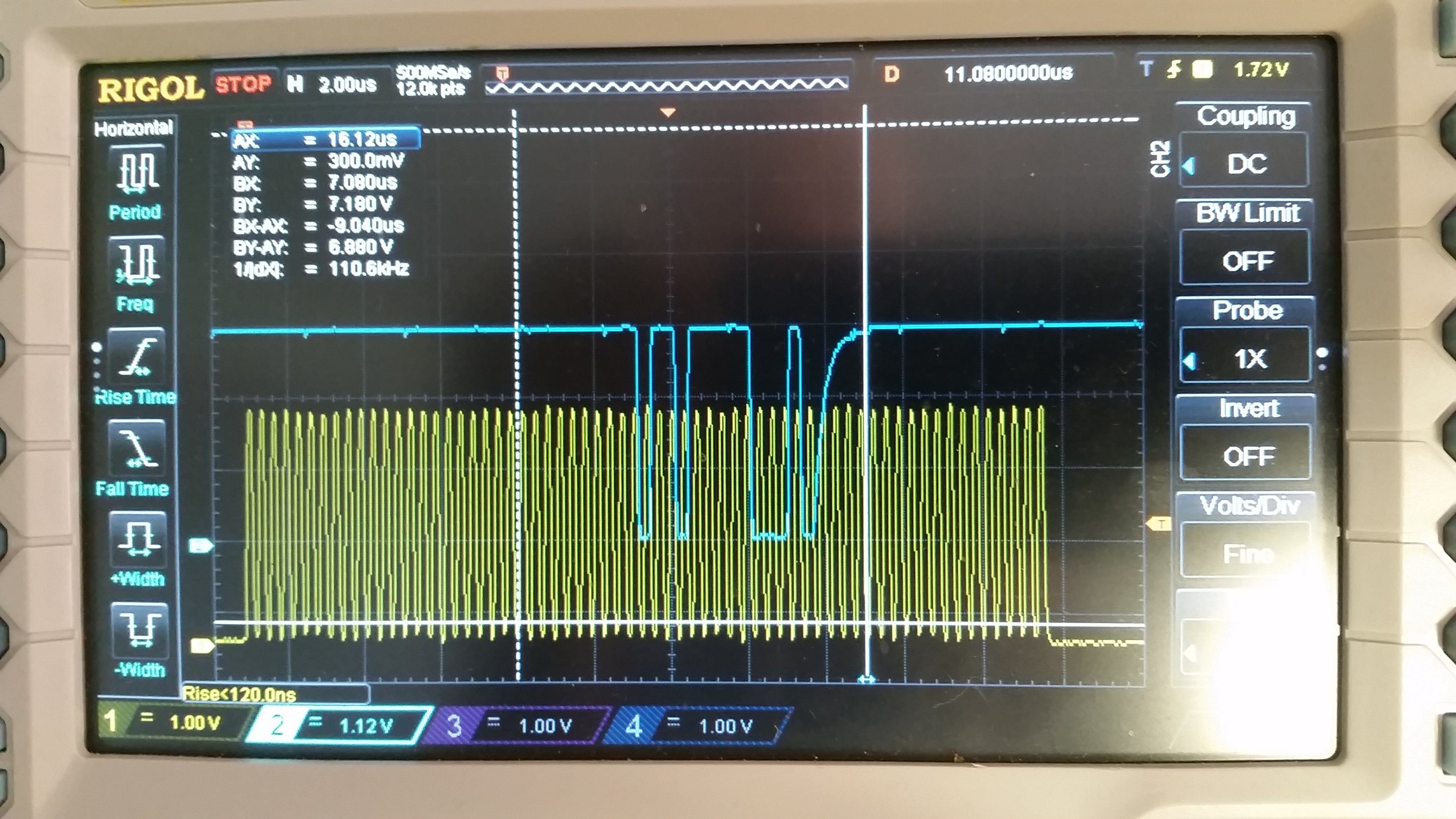

Not sure why I'm having a problem with this board a friend made. I'm running the ethernet_example in the IDF. I've checked and double checked that MDIO and MDC are the correct assigned pins. Not control over PHY power. I've included a scope capture that seems to indicate properly data coming from the ESP32. But the LAN8270 is not responding. Just a bunch of timeouts with register reading 0xffff on init.

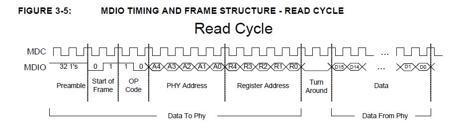

The init procedure writes to reg 2 & 3. The scope capture appears to be addressing reg2. It appears to have 32 ones, then SOF 01, then OPCODE 10, then PHY addr all ones, then register addr 2. It seems to release the bus and the signal is pulled high. Doesn't seem to obey the turnaround of two zeros. But maybe that's because MDIO is being pulled high.
I'm not expecting that with this info someone can debug the board. But was hoping that maybe somebody knew about some "gotchas" that may be impeding my progress. It appears the next step is to examine the LAN8270 and see if something is wrong with it.
John A

Super simple fix. The PHY was address zero and I was using address 31. :D
