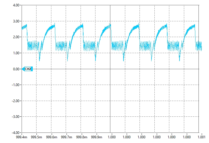

I am trying to use IO0 for SDA and IO4 for SCL in I2C. I have tried with 4.7k external pullups in both pins and no pullups as well. I2cscanners fail to connect to sensors. When I am using other pins everything works fine. Any ideas?

IO0 is a special pin that already has a pullup on it. Its used to program the part. I suggest looking at the data sheet first so you can understand what pins to use and not to.

I know how they function, nevertheless in the esp32 docs they say that after boot they behave like normal pins. I do use them for the boot process but it doesnt seem to be working, while the same software when its using other pins is working

Not sure, Personally I steer clear of using GPIO0. Throw a scope on the SCL/SDA lines and have a look.

Pretty sure that GPIO 0 is available after boot. If you are going work on stuff like this it's worth getting a cheap scope to analyze these kinds of problems.

there are not enough pins on esp32. I am already using port expanders, multiple multiplexers on that pcb. I need to make them work :) I will look with my trusted rigol. I was trying to determine if there is something internal that prohibits them to be used as i2c. they have internal pullups, they are IO (unlike >io34). so after boot they should work. right? the same software on different pins works like a charm

This is the code that I am running. I put a scope on IO0 and I get the attached signal. the same program on another pin works like a charm.

You never want to use internal pullups for I2C on ANY device. They will all be too weak to do the job properly.
