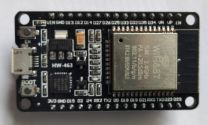

i am dealing with the same (worse) problem. Deep Sleep power consumption is 12mA on the naked dev-board (with the LED removed). I even run the board directly from 3,3V to the 3,3V pin. So i don't even use the LDO.
Any idea why it uses 12mA? I used the deep sleep example code for my tests without anything connected to the board.
When i cut off the CP2102N from the 3,3V line then the ESP won't work any more as expected. Maybe it is the CP2102N. But that chip should consume not more than 3mA. How did you desolder the CP2102N? Heatgun?
EDIT: I cut it off on the wrong spot. If the CP2102N doesn't get 3,3V. Then the power consumption reduces 10mA. At least on my board.
I am using the dev board in the attachment. If i run the ESP directly from 3,3V. Is there a way to cut off all the parts which consume power?
It's confusing. No LDO, No LED but still 12mA in deep sleep. Doesn't make sense to me. Hmm Any idea?
- scrnli_5_7_2022_12-01-06 AM.png (175.95 KiB) Viewed 11415 times
