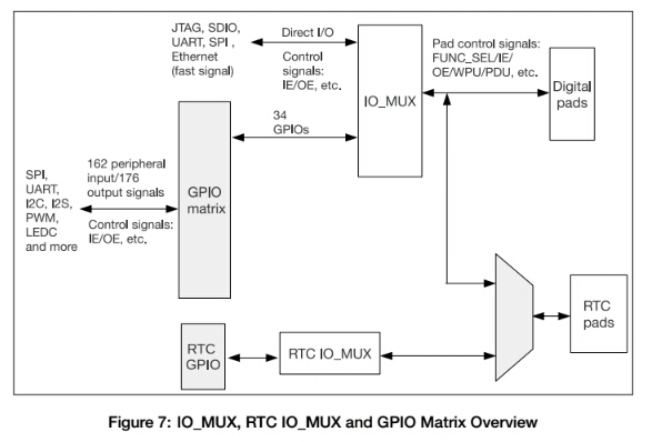

I'm having an issue with my wake stub.
My wakestub basically checks a few conditions on GPIO and ADC, and then puts the chip back to sleep if none of the conditions are met. Because of the RTC IRAM limitation of the wake stub, I basically took all of the IDF code relevant to me, and put it in a new file, called stub_sdk.c with some butchering to make things simple/work. This contains the idf functions to manipulate peripherals, but with the RTC_IRAM attrib so that they are loaded into IRAM and can be used in the wake stub. My first question is, is there a better way to do this? At least, maybe this will help someone who also wants to use these high level functions to configure their ESP32 peripherals.
I'm having an issue trying to set and hold an RTC io. It doesn't seem like the IO is getting held out of the wake stub. The IDF functions use some external macros/defines, some of which I have dragged to RTC ram to make them available to my "mini RTC IRAM idf". I'm wondering if there is anything in this file I have not caught which must be dragged to RTC IRAM?
This should keep the IO held after the chip goies back into deep sleep, correct?
stub_rtc_gpio_hold_dis(GPIO_NUM_32);
  io_conf.mode = GPIO_MODE_OUTPUT;
  io_conf.pin_bit_mask = ((uint64_t)1 << GPIO_NUM_32);
  io_conf.pull_down_en = 1;
  io_conf.pull_up_en = 0;
  stub_gpio_config(&io_conf);
stub_gpio_set_level(GPIO_NUM_32, true);
stub_rtc_gpio_hold_en(GPIO_NUM_32);

chris1seto
Posts: 20
Joined: Tue Jun 12, 2018 5:05 pm
Re: RTC GPIO hold enable from wake stub
Postby chris1seto » Tue Apr 30, 2019 11:36 pm
Ok, so looking into this more, the problem is definitely related to `rtc_gpio_desc`. I'm guessing this isn't loaded into RTC RAM in the IDF, but if I copy it from the IDF and use the signature RTC_RODATA_ATTR rtc_gpio_desc_t stub_rtc_gpio_desc[GPIO_PIN_COUNT] to declare it, then switch over the stub_sdk to use that array, the board will have a TG0WDT_SYS_RESET during execution of the wake stub... why though? There's nothing special about the content of the array, it's just int addresses of the registers, not even actual pointers.
The higher level issue is that the io stays held from when the application code went into deep sleep. Because the calls to unhold the io rely on this array, the gpio is never unheld.
RTC_RODATA_ATTR rtc_gpio_desc_t stub_rtc_gpio_desc[GPIO_PIN_COUNT] = {

I think you are mixing rtcio and gpio functions which are different.

When you call gpio_config it makes it a digital gpio and gpio_set_level is also a digital gpio function.
If you want to work in rtc domain use these functions https://github.com/espressif/esp-idf/bl ... r/rtc_io.h

I think the main issue is that right now, I can't even disable rtc holding on the pin after the application code sets rtc hold on the pin before sleeping. If I don't hold the pin before going to deep sleep, then I can manipulate the io state in the wake stub.

If I do a CLEAR_PERI_REG_MASK(RTC_IO_XTAL_32K_PAD_REG, RTC_IO_X32P_HOLD_M);, I can unhold this pin and control it correctly. But the routine in the stub_api does not work... Even if I relocate the rtc_gpio_desc into RTC ram. Is there something special about this array existing in RTC memory that could cause this to not work?

The reason is you didn't change rtc_gpio_desc to stub_rtc_gpio_desc (or __rtc_gpio_desc as you originally named it) inside the stub_sdk functions
