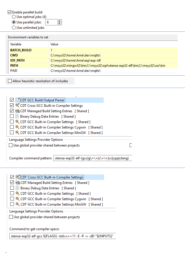

Here are the settings I use: What am I am doing wrong?
Please help

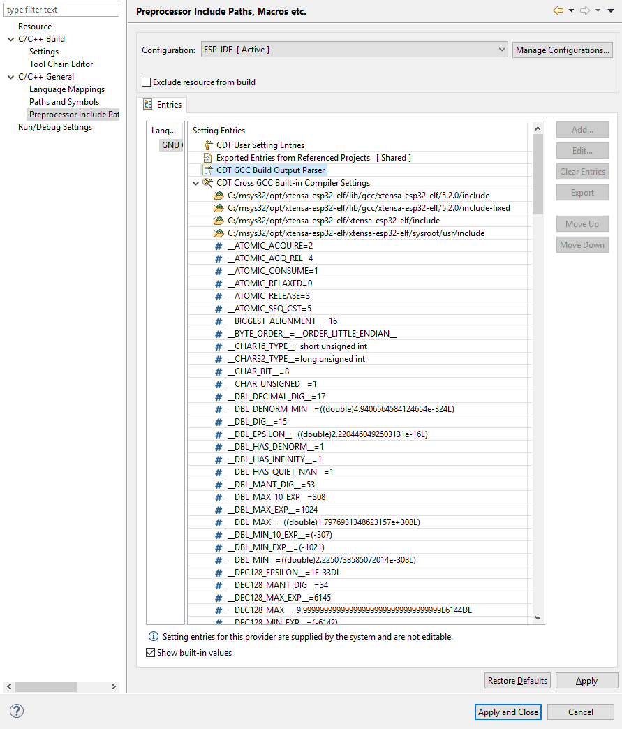

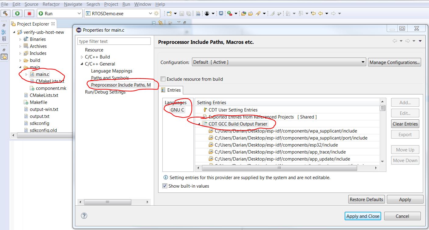

On one or more of your project files that are showing unresolved inclusions (e.g. main.c), could you post a screenshot of those files' CDT GCC Build Output Entries (see screenshot below). A log dump of your Eclipse build would also be helpful.

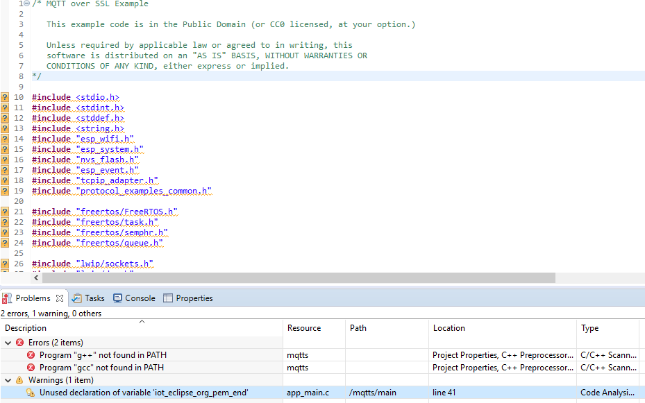

Here are the informations you want to have: The main-file I'm trying to edit is the mqtts-example in githubs esp-idf see
https://github.com/espressif/esp-idf/bl ... app_main.c
currently g++ and gcc are not found although the path has the following value
here is the eclipse-Logfile
Why does eclipse doesn't find gcc nor g++? Both gcc.exe and and xtensa-esp32-elf-gcc.exe are in the path.
C:\msys32\mingw32\bin;C:\msys32\opt\xtensa-esp32-elf\bin;C:\msys32\usr\bin

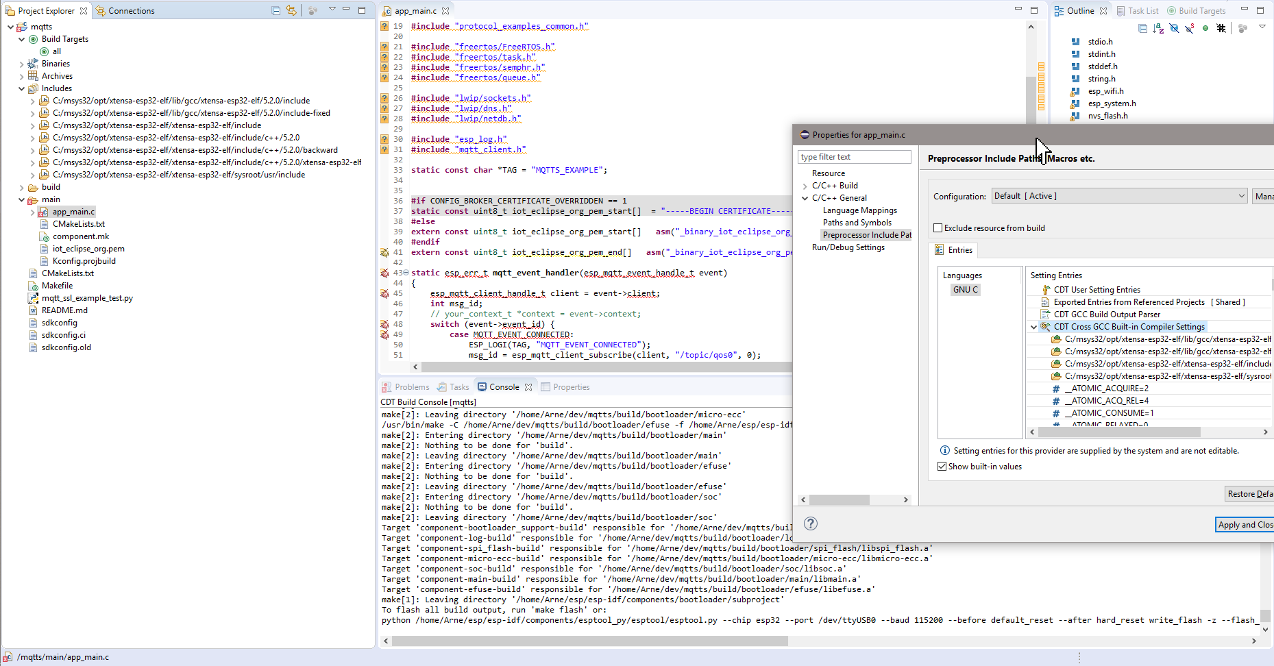

I deleted everything again (workspace and the project itself) and recreated it according to the instructions. https://docs.espressif.com/projects/esp ... setup.html
Here is the log-File I found in the workspace Here are the settings you would like to see Hope, that helps.

@dasarne by log I mean the Build Log. You can enable it under Project Properties->C/C++ Build->Logging and check Enable Build Logging. Run a full build to generate a complete log output (i.e. clean the project before building all).
From the screenshot you've provided of the CDT Build Console it seems like the build process is able to run successfully, but for some reason the CDT GCC Build Output Parser isn't able to parse any of the paths from the build process. The build process should output multiple calls to gcc or g++ such as the following:
It is these outputs that the parser is supposed to derive the CDT GCC Build Output Parser is supposed to parse the Build Output Entries from. I need to see your Build Log to check what type of outputs (if any) are being emitted during the build process to prevent the CDT GCC Build Output Parser from being able to parse entries from.
xtensa-esp32-elf-gcc ... a bunch of options ... -I /c/Users/Darian/Desktop/esp-idf/components/freertos/include/freertos
