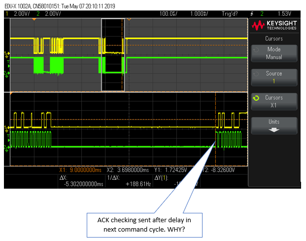

Dear all,
I am struggling with I2C bus and reading measurement from SHT30 sensor.
I am able to read serial number and status register therefore i2c driver, i2c bus and sensor should be working.
But for measurement readout in polling mode I need to create special sequence to "poll" if measurement is ready or not.
I create this sequence exactly according SHT30 specification and example source code.
Here is my readout code snippet:

1. My first question is following:
Why ACK/NACK checking are sent in next command cycle?
See this picture for better view. Position of cursor shows ACK checking. This checking is sent after first 1ms delay in code.
2. My second question is, if there is something wrong in my code, because it is not working at all.
Is there any way how to make polling functional?
How to force I2C driver to send ACK/NACK checking in one command stream?
Thank you for your help.

I would like to add some notes to the case.
In debugging mode, when I jump over line:
 i2c_master_cmd_begin(i2c_port_num, i2c_command_handle, I2C_READ_WAIT_MS / portTICK_RATE_MS);
there is no ACK/NACK checking clock. This ACK/NACK clock appears in the next cycle of:
Any idea what could be the reason?

marekg
Posts: 10
Joined: Thu Apr 18, 2019 2:08 pm
Re: I2C polling and ACK/NACK checked in next command
Postby marekg » Thu May 09, 2019 10:04 am
I found some posts that is there is only one command in the command queue, this results to timeout. Is that true?
This looks to be my case as well.
I am talking about such code:
        //create new i2c link for i2c commands
        i2c_command_handle = i2c_cmd_link_create();
        //queue stop bit
        i2c_master_stop(i2c_command_handle);
        //begin i2c command
        //delete link to release i2c resources
        i2c_cmd_link_delete(i2c_command_handle);
Is there any way how to fix it?
Thank you for help.
IIXII78
Joined: Wed Jun 19, 2019 9:03 am
Postby IIXII78 » Thu Aug 01, 2019 1:46 pm
I can confirm this behaviour, the clock pulse for the ACK bit is indeed only sent together with the next command. The bit isn't even evaluated for the last command in a sequence, so there is no error returned even if the ACK check should fail.
This could be called a hardware bug in the Command Controller of the ESP32 I2C peripheral, but it was probably designed with the assumption that every command sequence always ends with a STOP condition, so that any outstanding ACK is always processed.
Users browsing this forum: Baidu [Spider], Google [Bot] and 1 guest
