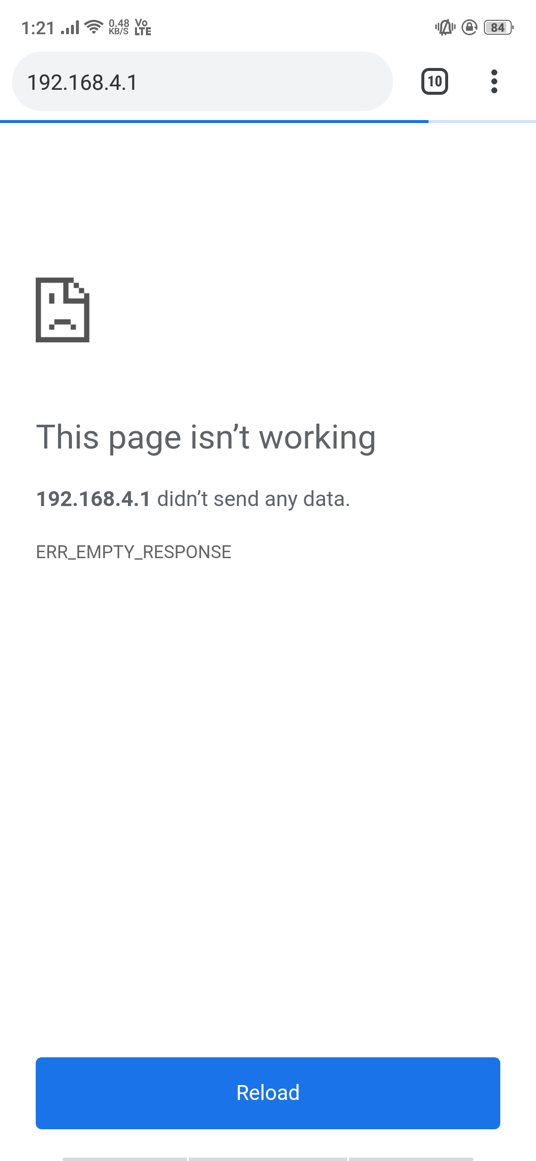

When I am testing with the AP mode of the ESP32 with ESP IDF v3.1.3. The Wi-Fi module which is set as an AP mode was successfully connected with Mobile or Tablet with the configured SSID and Password. The request sent from the browser to the ESP32 and response page sent to the browser from the ESP32 to be displayed on the webpage(http:\\192.168.4.1:80) is actually not displayed on the latest chrome version(v74.0.3729.136)

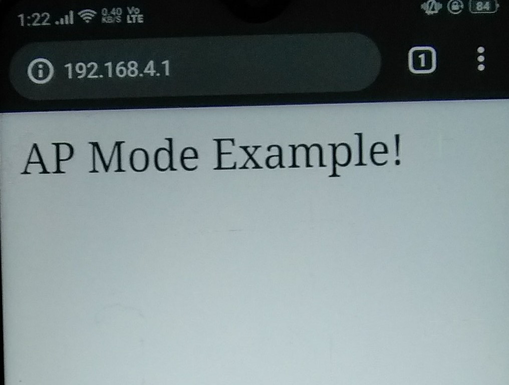

Same code was able to show the response page successfully with other browser's like Firefox (v66.0.5),Opera(v51.3.2461.138727). But in the latest version of chrome, the incognito window is able to give the response page successfully. Also in older version of the chrome(v71.0.3578.99), the response page is successfully posted on the browser irrespective of incognito or normal user mode.
Below screenshot illustrates, the response page received on unsuccessful posting on the web page with chrome's normal user window.
Below screenshot illustrates, the response page received on successful posting on the web page with chrome's incognito window.

Can anyone help me understand, why the AP mode in ESP32 is working fine in Chrome's incognito mode and not in the normal user mode of the latest version of the Chrome?

Your code assumes a browser always sends one request at the same time; you e.g. only have one temp_buff that is shared by any request that happens concurrently. My guess would be that that assumption is wrong. Suggest you either change your code, or use e.g. Wireshark to find out what exactly is going on.
