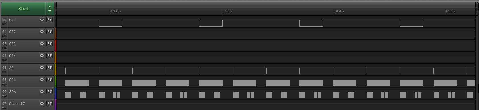

Hi :)
I'm currently working on a little project that uses 4 LCDs (st7735 controller). They are connected as followed:
Mosi=4 , SCK=14 , A0 = 5 , CS1=2 , CS2= 26, CS3= 25, CS4= 32
Problem: Only CS1 (GPIO2) will work. All other CS stay low. I can't think of any reason why :cry:
This is my code. I also attached the code in a .zip below. Please help, this is driving me crazy :?
Code for Main.c . Only 3 Displays are used at the moment, so the second SPI is commented out.

	// Hardware kann nur 3 CS bedienen, daher 2 SPI Busse für 4 Geräte :(
	// Mosi=4 , SCK=14 , A0 = 5 , CS1=2 , CS2= 26, CS3= 25, CS4= 32
	// Mosi=25 , SCK=27, CS4= 18
	LX_Init_SPI(VSPI_HOST, 4, 14, 1);
	//LX_Init_SPI(VSPI_HOST, 23, 24, 2);
	LX_Create_Device(VSPI_HOST, &Display_Handler[0], 2, 5);		//pink
	LX_Create_Device(VSPI_HOST, &Display_Handler[1], 26, 5);	//gelb
	LX_Create_Device(VSPI_HOST, &Display_Handler[2], 25, 5);	//grün
	//LX_Create_Device(VSPI_HOST, &Display_Handler[3], 32, 5);	//rot

Code of the LX177B.c Display Library

	spi_device_interface_config_t LX_Config;
	memset(&LX_Config, 0, sizeof(LX_Config));
	LX_Config.address_bits = 0;
	LX_Config.clock_speed_hz = SPI_MASTER_FREQ_16M;				//16,6Mhz theoretisch ok
	LX_Config.spics_io_num = NSEL;
	LX_Config.queue_size = 4;
	LX_Config.mode = 0;
	LX_Config.cs_ena_pretrans = 2;
	LX_Config.flags = SPI_DEVICE_HALFDUPLEX;
	//Dem zuvor initialisierten Bus ein Gerät hinzufügen
	ESP_ERROR_CHECK(spi_bus_add_device(SPI, &LX_Config, SPI_Handler));
	ESP_LOGI(LX_TAG,"GLCD: SPI Device created, CS= %d,A0=%d",NSEL,A0_Pin);
