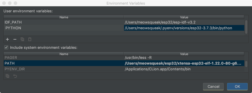

@ESP_cermak, thanks for your reply.
I thought I'd try setting it up "from scratch" on my Mac (Mojave, 10.14.5) which I already have ESP IDF v3.2 installed on. I have cmake 3.14.0 installed.
I did a fresh install of CLion 2019.1.4 and opened the CMakeLists.txt file from a freshly copied (from IDF v3.2) getting_started/hello_world example directory. I chose all the defaults for CLion's toolchain, etc (i.e. the default Apple toolchain, didn't choose anything ESP32-related).
I then opened the CMake Environment settings and set IDF_PATH to the path to my IDF v3.2 directory: /Users/meowsqueak/esp32/esp-idf-v3.2/. I am using pyenv on Mac too, so I set PYTHON to /Users/meowsqueak/.pyenv/versions/esp32-3.7.3/bin/python and made sure this virtualenv has the requirements.txt from IDF v3.2 installed (it already had).
I also had to add the path to the Xtensa toolchain to the start of my PATH variable (I have "Include system environment variables" ticked): PATH=/Users/meowsqueak/esp32/xtensa-esp32-elf-1.22.0-80-g6c4433a/bin:[original setting]
When I "Reload CMake Project" in CLion I get the following error:
I took a look in CMakeError.log:
So I'm seeing the same error on both Mac and Linux with an IDF Example (I'll worry about the git submodule issue once this is sorted).
Do I need to explicitly set up a toolchain in CLion for Xtensa?

Hmm, a breakthrough!
I was using the Environment "table" under Build, Execution, Deployment > CMake. I clicked the little rectangle symbol on the right and was adding IDF_PATH and PYTHON variables there:
However it turns out that this doesn't work on its own for IDF_PATH. Because if I specify -DIDF_PATH=/Users/meowsqueak/esp32/esp-idf-v3.2 in the "CMake options" field it does work:
Once I do this, on my Mac at least (will test on Linux soon), the Hello World project now builds without errors.
But here's the weird thing - IDF_PATH has to be set in both the Environment table and the CMake options field. If it's only in one or the other, it doesn't build. If it's missing from Environment I get:
- as if the IDF_PATH prefix isn't defined.
Any idea what's going on here?

Looks like I'm getting the same behaviour on my Linux system - IDF_PATH must be set in both the command line (as -DIDF_PATH=...) and in the Environment table. If it's in neither or only one, I get an error from the IDF .cmake functions as per above.
I naively assume that anything in the Environment table gets converted into "-DVAR=..." options on the cmake command line, so I find this very surprising!
EDIT: I solved my "git submodules" problem - I had changed the system PATH variable to read "/path/to/my/xtensa/toolchain:$PATH" but apparently $PATH won't expand in this case, and that probably meant that almost everything was no longer in my path, including the git binary. I reverted this and added the path at the front of the system value and that must have fixed this issue.

Sharing my experience as well. I've had the same error as you did. Having ESP-IDF environment variables (IDF_PATH, addition of toolchain to PATH) in ~/.profile made import of CMake projects seamless for me.
Re: Help using CLion + CMake + ESP-IDF v3.2.2
It is Windows experience, but may help. Only that's needed for work well with CLion
Set Environments in linux way, it is nice to do with ~/.profile as Renz said:
IDF_PATH=C:\Users\dongr\esp\esp-idf
Path= %IDF_PATH%/tools; C:\msys32\usr\bin; C:\msys32\opt\xtensa-esp32-elf\bin; C:\Program Files\Git\cmd; C:\Python37\; C:\Python37\Scripts;
Update project's CMakeLists.txt with added compiller vars
And do not forget to execute from IDF_PATH folder
cmake_minimum_required(VERSION 3.5)
set(CMAKE_C_COMPILER xtensa-esp32-elf-gcc)
set(CMAKE_CXX_COMPILER xtensa-esp32-elf-g++)
set(CMAKE_ASM_COMPILER xtensa-esp32-elf-as)
include($ENV{IDF_PATH}/tools/cmake/project.cmake)
project(blink)
Code: Untitled.bsh Select all
git submodule update --recursive --init
