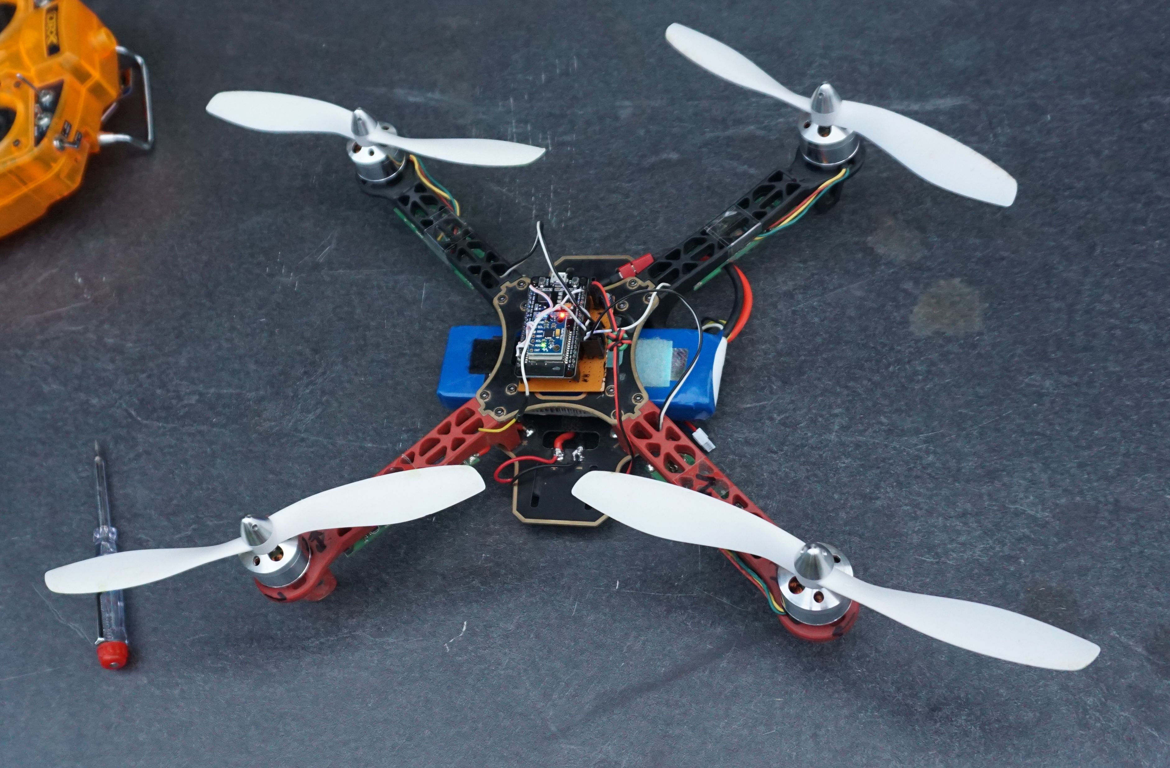

Re: ESP32 resets on mechanical shock
Your 6050 data goes over an angular velocity limit and crashes the esp32? Try lowering the sensivity in the 6050 setup.
I do fly quadcopters with esp32 + mpu6050 and never have this problem, not even on "hard landings".
Hey VladTheImpeler
And what is the sensitivity of your 6050 (250 to 2000)? I had no success in this direction...
Maybe a poor power supply. What do you use as power supply for your quad-copter? What battery? Some capacitor, what value (uF)?
The answer for this questions may help me.
Thanks in advance...
