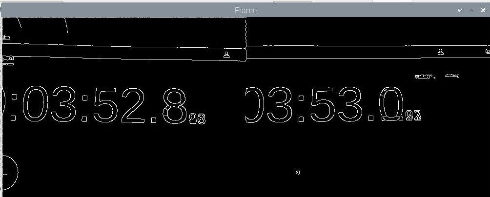

Hi
I would like to stream two pictures captured synchronously by two ESP32-CAM to a Raspberry PI4.
Problems:
a) the two ESP32 blocking each other, the video stream is not stable.
b) Pictures are not taken synchronously.
my approaches:
@a
- reducing the frame rate, I don't need more than 1-2 frames / second
- streaming over two different WIFI channels, but than I would need to add two USB-WIFI-HotSpots to the PI
- external antennas increased the transfer rate, but doesn't improved the stability.
@b
- Idea is to connect both ESP32 with a wire and trigger an interrupt to capture synchronously the picture.
- Adding fb = esp_camera_fb_get() to the interrupt routine causes a watchdog error.
- I don't understand well how the server routine works, so no idea how to get this synchronously to the interrupt.
- Is it possible to stream just 1-2 frames/seconds or does this cause timeouts?
- delay in the main loop reduces the framerate, but is this the correct way?
- is there a way to add a counter to each frame?
Then the PI could check if both frames have the same timestamp.
How could I solve this?
Thanks for all hints and ideas :-)
On the PI I have installed opencv, would like to work with depth maps to control a robot.
I used the code from here:
https://randomnerdtutorials.com/esp32-c ... assistant/
I added a 1Hz output clock on pin4 and a input interrupt on pin12.
interrupt routines need to be short, and capturing frame takes several 100s of milliseconds, that is too long.
800x600 resolution gives 6fps for my ESP32-CAM modules, so should suffice for 2x2fps.
I don't currently know of a different method to reduce framerate.
Not nice, but if it does what you want, OK.
CamWebServer "Get Still" button calls esp_camera_fb_get(), so response is a JPEG image.
JPEG images have exif metadata that can be viewed with a exif reader or graphics program.
Click "Get Still" in CamWebServer, right click on frame received, open in new browser tab and store with eg. gimp.
Then use exif viewer to see whether timestamp is set, and what the resolution is.
Because of the low framerate you should use 2Hz and actively wait for GPIO signal change on ESP32-CAM (simple loop with small delay), then capture image and wait again.
Because of both ESP32-CAMs triggered by same signal, esp_camera_fb_get() gets executed on both modules at roughly the same time. Execution time of esp_camera_fb_get() is different though, changes in 10% duration range for each call.

Insert a semaphore in "stream_handler" in between
 while(true)
and
esp_camera_fb_get();
This will delay grabbing the picture until you sync it.
If you dont know semaphores a
        while (!newpic) delay(10);
        newpic = false;
will do, you can set
newpic = true;
in main loop with appropriate timing.
More of a challenge would be to connect 2 cameras to one esp32.

Hi thanks for your answers.
Yes, I did it like this some days ago and it's working quite good.
I tried to write a comment here, but posting always takes one day for moderator verification.
Without an active stream the timing runns perfect. (see the list below)
With an active stream the timing struggels, I'm not sure if it is stable enouth for the stereo depth maps algorithm.
(I don't have a timing list for active stream here, will post it later, but looks terrible)
Sometimes picture aren't be send withhin the period of the 500ms interrupt.
That causes corrupted pictures. I will test this again with a external wifi antenna and a dedicated router to encrease transfer rate.
Could anyone take a look at my code, is there something I can improve for the timing?
Is there a difference between those two while loops on ESP32?
while(!newpic) {} and while (!newpic) delay(10);
Can the delay be used for different tasks or is this just a counter as on 8Bit Atmegas and it makes no difference?
Both of my ESP32-Cam are getting quite warm. I sticked the camaras on the warm SD-card cage, but one of the camaras already died.
Don't know why, I have an ESD save workplace, power supply should be good enouth.
Today I should get a new one delivered, than I will start to setup the depth maps algorithm.
timing without active stream:

lukas1000
Posts: 7
Joined: Mon Jul 29, 2019 7:29 pm
Re: Two ESP32-CAM synchronously streaming to PI4
Postby lukas1000 » Fri Aug 02, 2019 7:39 pm
Thanks for all your answers, I will read them carfully and try to learn :-)
I the meantime some updates:
My current setup is:
ESP32-Cam_Board1: (master)
Pin 2: output 500ms on/off signal
Pin 14: Input for on/off signal
connected external WIFI antenna (changed jumper R)
connected FTDI Adpater
ESP32-Cam_Board2: (slave)
Pin 2: output 500ms on/off signal (not connected)
Board1_Pin2 is connected to Board1_Pin14 and Board2_Pin14
-> Goal is, that both boards take a picture at the same time.
I tried to attach an interrupt to Pin2, but I always got a panic (LoadProhibited)
So I added the following line to the server thread:
while (digitalRead(trigger_in_pin) == pin_toggle_in)  { }
    pin_toggle_in = !pin_toggle_in;
Code is working, but delay is terrible, both received pictures do not match
Timing with only one ESP:
struggles at beginning, but than it runs quite accurate
pc (picture taken) is between ***192 and ***281, don't know if this is accurate enough.

Timing with both ESP active:
You can see, that timing of the server routine se is printed directly after trigger, looks like it is ~500ms delayed.
20:59:30.072 -> tt 11755165
20:59:30.574 -> tt 12255165
20:59:31.076 -> tt 12755165
20:59:31.581 -> tt 13255165
20:59:32.079 -> tt 13755180 | pd 13928319
20:59:32.583 -> tt 14255167 | se 14563217 | ps 14563238 | pc 14563263 | pd 14563291 | se 14654807 | ps 14702941 | pc 14703012 | pd 14736270

Attached you can find my latest code.

Postby lukas1000 » Fri Aug 02, 2019 7:47 pm
Hihi, my wife stopped watching netflix.
WIFI camera delay is now much better :-)
But still a lot of things to improve.
Attached my first synchronously taken pictures with opencv edge detection script on the RP4.
But still 0.1 seconds delay between the pictures.

@Mr VladTheImpaler Super Brain: is posting such trash the reason why you are registered here?
If you are not interested on others projects I would recommend to find a different hobby.
And sorry I'm not from Germany, you have to find a new picture.
People above mentioned a lot of methods how to improve my project, thanks to all of you.
Unfortunately my day has only 24h and I haven't enough time since yesterday to learn all of this methods, but I will.
I just thought it would be nice to post some of my project achievements here for people who are interested on such things.
Adding a delay of 1ms to the loop will definitely add an additional inaccuracy of 1ms between trigger and capture.
The most important task in this project is to capture both pictures as simultaneously as possible.
My first solution without active WIFI had an divergence of less then 0.01ms. So looks like it should be possible.
Further the ESP32 has two cores, so why is it terrible to block one of this cores for the most important task?
Mr Super Brain, could you please tell me your solution how to improve the time accuracy for capturing both pictures simultaneously?
Next idea would be to add a 3rd camera in a wider distance. Then it should be possible to measure near range with the first 2 cameras and higher ranges with the 3rd one.
Thanks
Lukas
