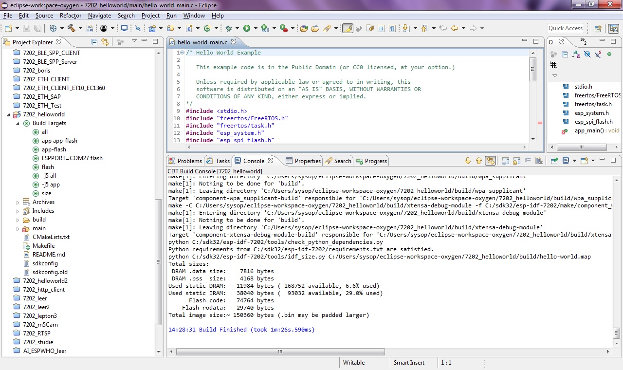

am using eclipse(oxyzen.3A) ide,how i can find the code size like RAM ROM which is used by project.

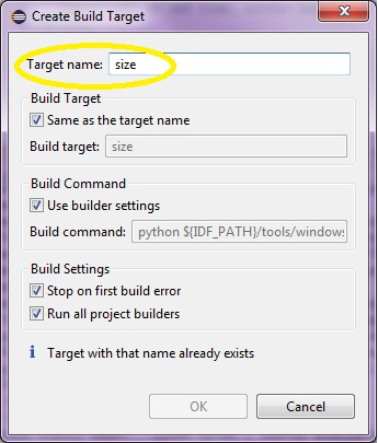

the info can reflected by esptool ( Makefile )
also showed in eclipse (example in console).
edit:
example:
create a new target "size"
use it for your reference
example simpy "make size" / run build target "size"

but did not understand these two lines, where it will store is it in ROM or flash?
Flash code: 833726 bytes
Flash rodata: 210176 bytes

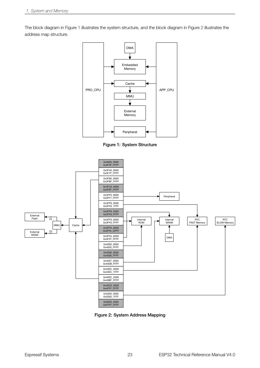

the ESP32 memory map you find example in the ESP32 Datasheet Section 3.1.4
also you can study the ESP32 technical reference Section 1 System and Memory
