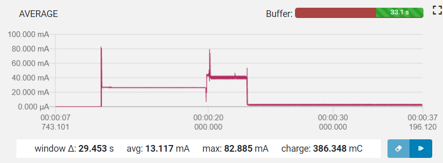

This is current when it is run:

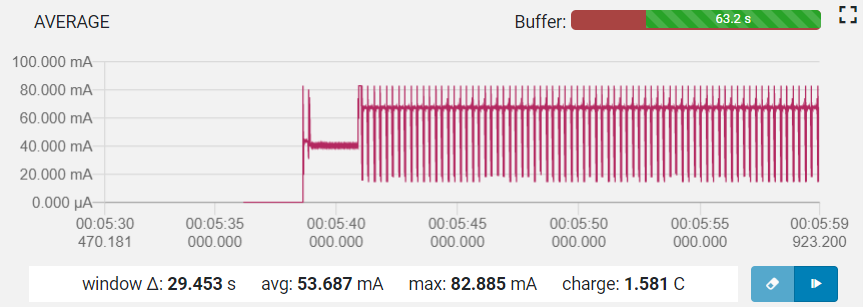

This is current when WiFi.begin is commented:
This one is with https://www.espressif.com/en/products/h ... c/overview
But it is similar with https://docs.espressif.com/projects/esp ... o-kit.html
How is it possible to reduce current in deep sleep?
