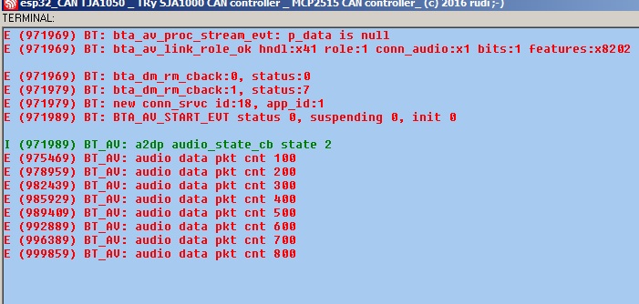

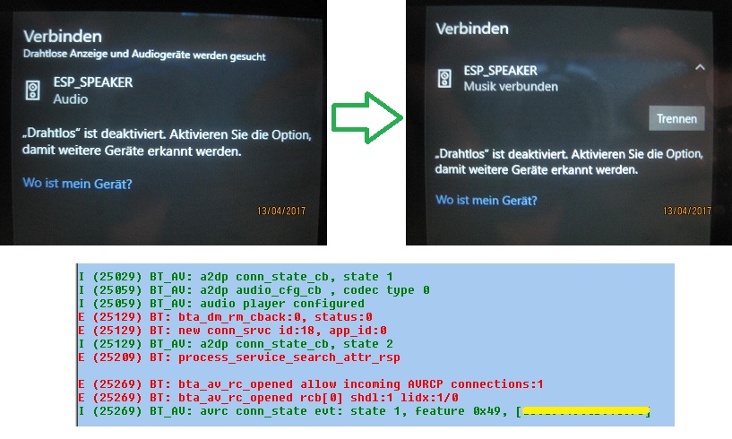

A2DP-SINK demo
perhabs you have a try here
After the program started, other bluetooth devices such as smart phones can discover this device named "ESP_SPEAKER", and after connection is established, audio data can be transmitted and there will occur a count of audio data packets printed.
happy easter17!
rudi
edit:
test with win10
connect to esp_speaker
and mediaplayer streams audio packet's to esp32 --
( debug msg on uart )
