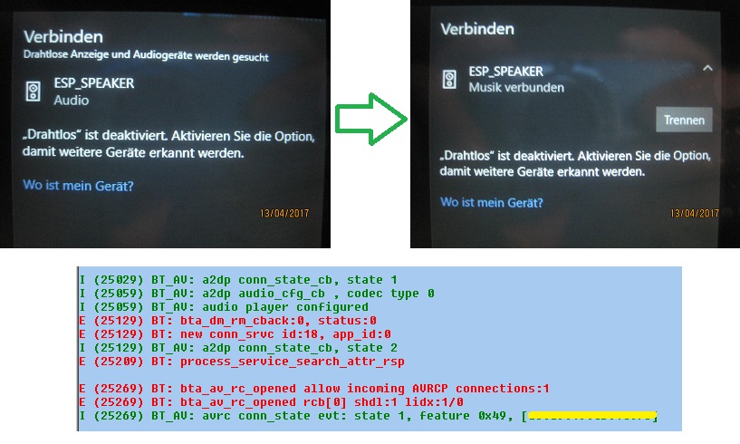

Posted: Thu Apr 13, 2017 4:25 pm
by rudi ;-)
we are considering using ESP32 in audio application, i.e. for creating a BT speaker.
We would like to ask what kind of audio support does ESP32 have? Is this support already implemented in SDK?
Can ESP32 be used for HiFi audio applications (i.e. BT speakers) and what is the overall quality of audio? What audio profiles/codecs does it support? Does it suport Advanced Audio Distribution Profile (A2DP)?
We are considering connecting a full digital amplifier - like this one: http://www.st.com/web/catalog/sense_pow ... 6/PF253416, directly to I2S outputs. Will this work with ESP32?
Best regards,
Drasko
hi drasko
@barometre
@danchiche

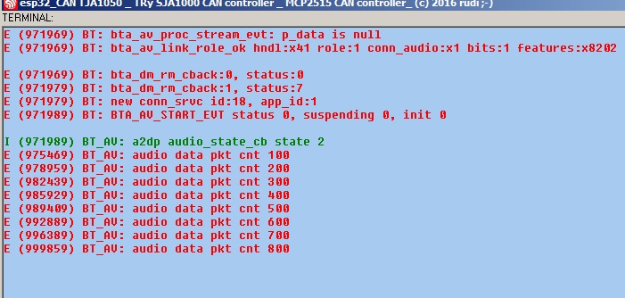

A2DP-SINK demo
perhabs you have a try here :)
After the program started, other bluetooth devices such as smart phones can discover this device named "ESP_SPEAKER", and after connection is established, audio data can be transmitted and there will occur a count of audio data packets printed.
happy easter17!
edit:
test with win10
connect to esp_speaker
and mediaplayer streams audio packet's to esp32 --
( debug msg on uart )

Re: Audio Support
Posted: Sun Apr 16, 2017 1:06 pm
by Vladislav Knyazkov
Yes
Nice job @Espressif - BT audio packages comming through
But the example fails after latest SDK lib's update. Issue #520 "Invalid cache access somewhere in BT" @ github
