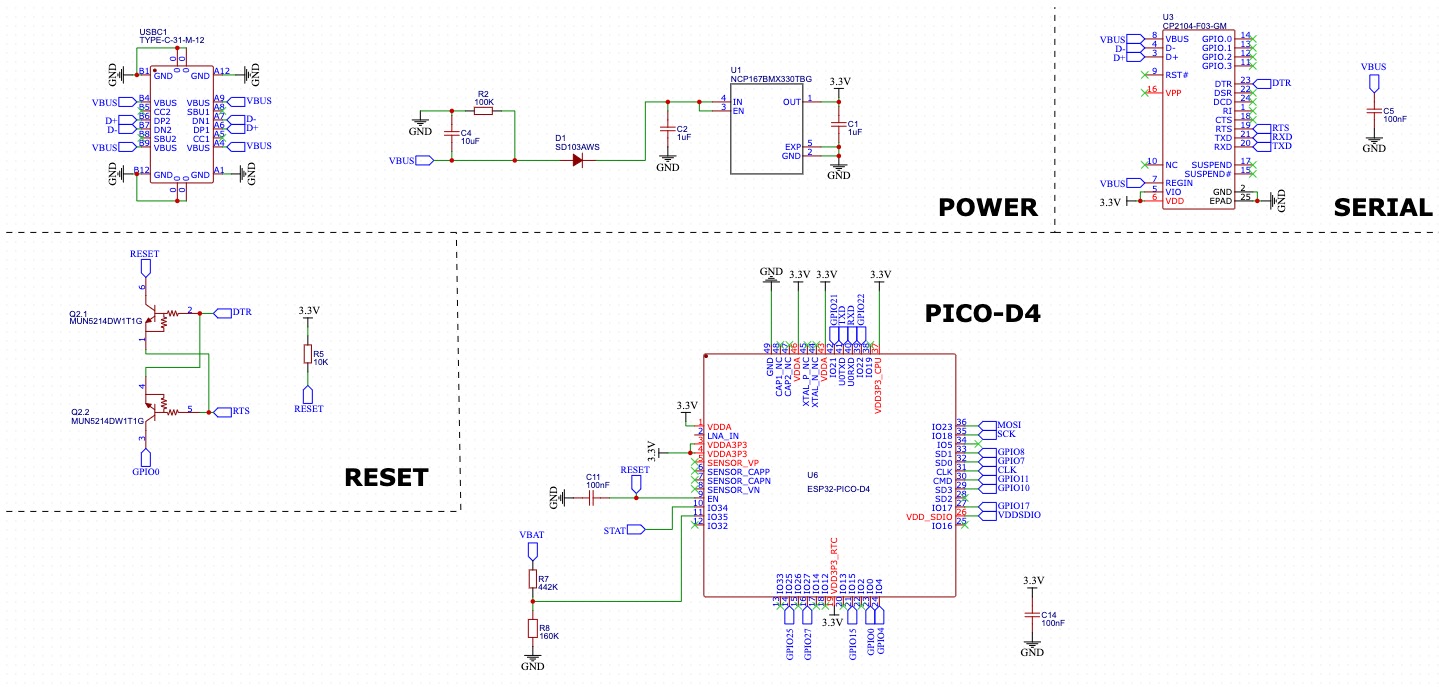

I am currently developing a custom PCB for a hobby project and for that I used a Pico-D4 chip and a CP2104 serial chip. As you can see in the schematic, I used a common two-transistor auto boot sequence "selector" circuit for programming.

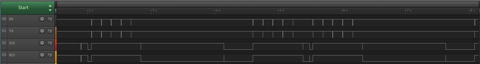

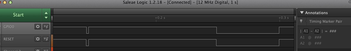

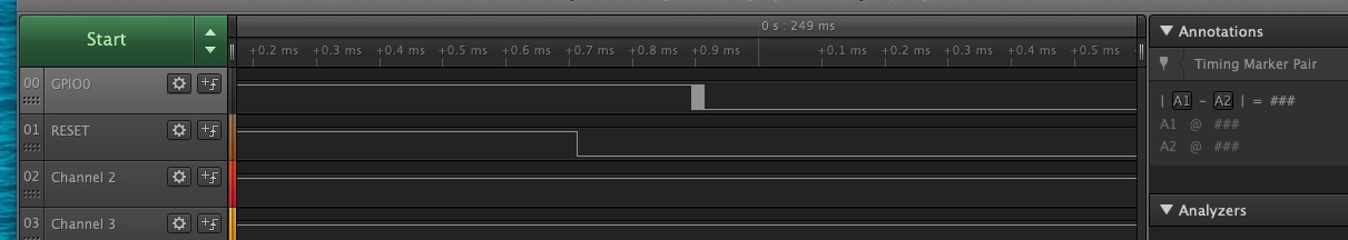

The problem is that I always get a "timed out waiting for packet header" error when I try to program it. I first thought that I have a faulty solder connection but after double checking, I concluded that everything is ok and I attempted to hook up my logic analyzer. As you can see in the data capture screenshot, in general I receive a low on IO0, followed by a low at RESET and then IO0 -> high and then RESET -> high.
If I trigger this sequence by hand via two jumper wires, I can program the chip but the automatic programming does not work.
Also the captured data looks really odd. You can download the whole saleae data file here: https://www4.zippyshare.com/v/o5px217q/file.html

In the logic captures, it looks like that there is no signal present on the TX line, despite correct wiring and soldering, I also took a capture on the CH2104 pin directly.

Hi GatCode,
No output at all from the chip is weird. Any time the EN pin on the PICO-D4 goes from low to high there should be some serial output of some kind, even if it doesn't boot into the right mode.
The first trace you posted shows a weird oscillation on the rising edge of RES. Is it possible the pullup resistor R5 has a soldering issue or is pulling to the wrong power rail? If you look at this signal on an oscilloscope, what do you see?
Angus

thank you for your answer, I just switched out the R5 and rechecked all pins on the ESP32 since I have no access to an oscilloscope.
As you told, I am getting a response from the ESP32 but nevertheless, still the same problem at upload.
In the image below you can see what I mean (all measurements are taken directly on the ESP32 pins - hence the names)
Also here is the capture file: https://www10.zippyshare.com/v/3NtbkbaY/file.html
Is it normal that the chip answers so little?
