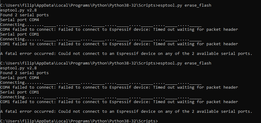

I had been programming ESP32, I had problems with connecting to the device, which I had solved by putting a capacitor between EN and GND pins. Everything had worked for month or something but today, when I tried to load new code for my long-term graduation project to test, the same problam had poped up.
At first I thought it might be because of the bad connection or something, so I unplugged esp and tried loading the code while holding "boot" button while the board connects. Nothing.
So I tried updating my usb drivers, using another PC, changed about 3 usb cables.. nothing.
Last thing I tried was fleshing the board. Same result.
I am buying a new board. But I would be really happy if there was anyone, who could tell me what could have happend and how to prevent that from happening with my new board.
Thank you for answers!
Screenshot of cmd
