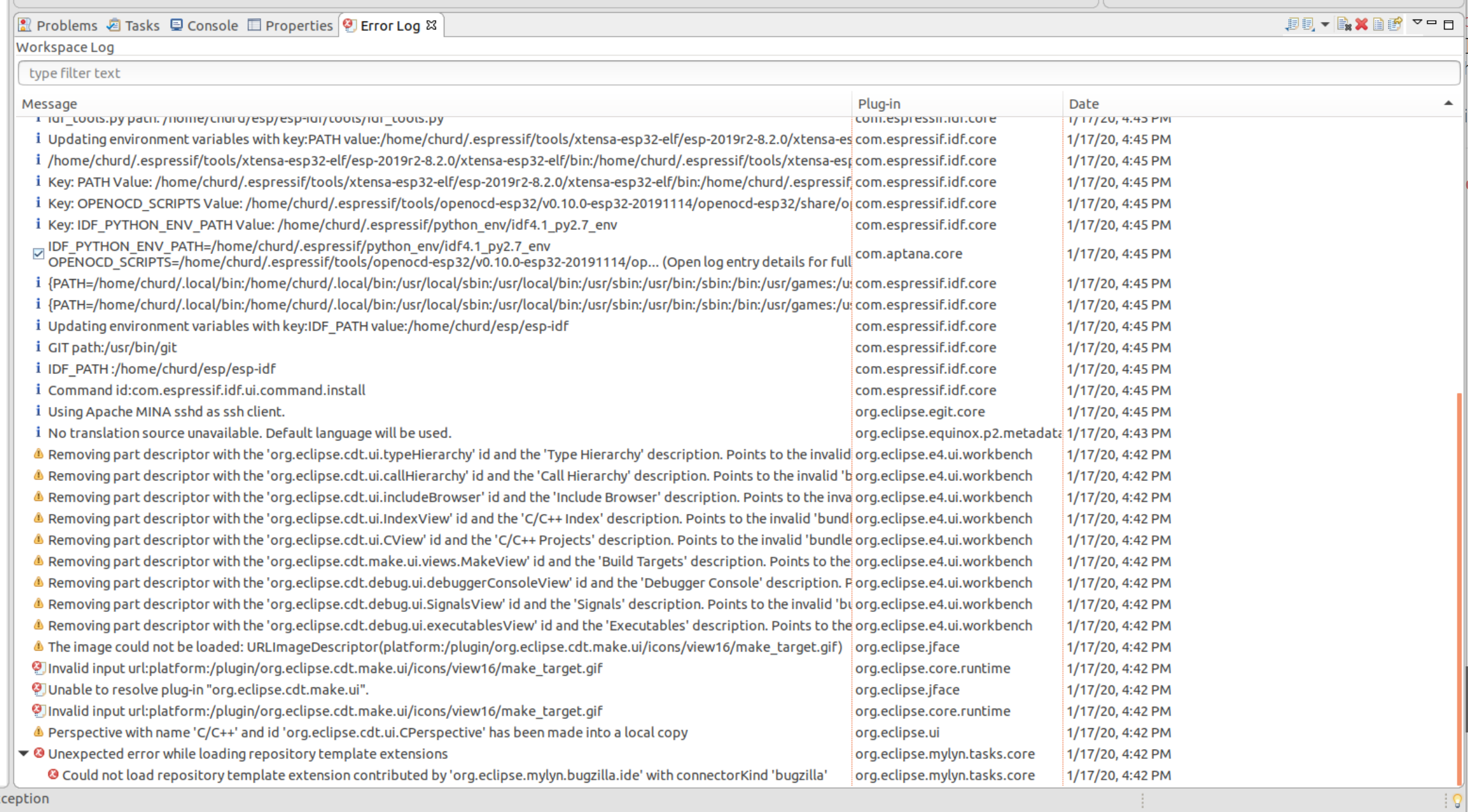

Hope you've ran "install tools" from eclipse. This will take care of installing and configuring required paths for the eclipse to run esp-idf projects.
Anyway, please send us the error log to see the reported error.
https://github.com/espressif/idf-eclips ... #error-log

Enclosed is the log, as well as a picture. Thanks for your help. :)

Found the problem! The tip from kondalkolipaka about the error log did the trick - thank you. I'm not much of an Eclipse guru, so I didn't know the log was available.
When I would click the Finish button, that's when you'd see the Unhandled Exception in Loop error show up. If you look at the stack trace it would say:
java.lang.NoClassDefFoundError: javax/xml/bind/JAXBException
A few minutes with Stack exchange found this article:
https://stackoverflow.com/questions/435 ... ption-in-j
Long story short, JAXB is not available on the classpath in Java 9, and removed entirely past Java 11, and I was using Java 13. If you're using a newer version of Ubuntu like 18.04 you have to install an older version of Java 8 like this:
sudo apt install openjdk-8-jdk openjdk-8-jre
And the plugin will work. Hope this saves someone some headaches. :)

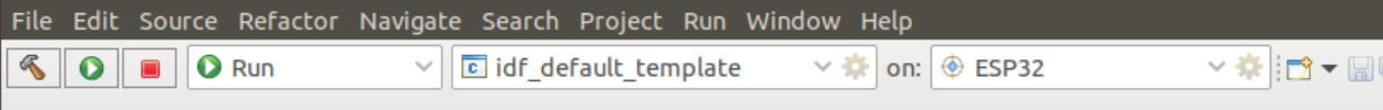

Discovered another thing. Ubuntu 18.04's version of Eclipse doesn't like the plugin even if you have the correct Java installed. You have to use the version of Eclipse mentioned in the readme.md. Use this Eclipse:
https://www.eclipse.org/downloads/packa ... developers
Or else you won't get the Toolbar you need. It's easy to do. Just download, unzip, and run.
